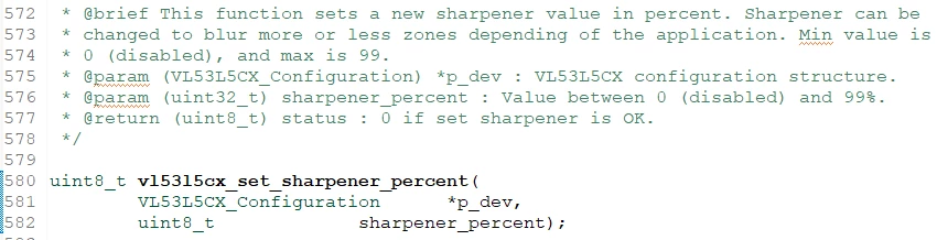

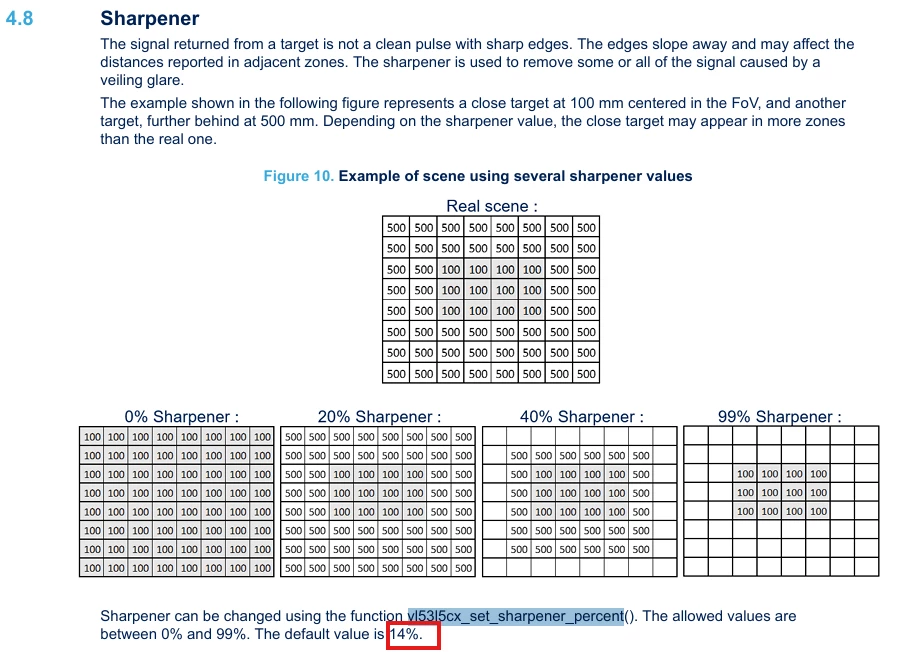

when set Sharpener = 0%, which means disable sharpener. every zone will report the closest distance measured and there will be no impact between each zone.
But when you set Sharpener = 5%, enable sharpener feature.
As you enable sharpener feature, by default Sharpener setting is 14%. and get raw frame (include distance and status and signal).
here is the thing, when the secondary target approaches the primary surface. sharpener feature grouped all zones as one. then calculate a Blur Decision threshold by the sharpener percent and max signal.  For example, the real frame you provided, the max signal is 9217.  Blur Decision threshold ≈ 1300. if signal < 1300, then make it as blur.
So, based on your information, I think it’s an expected result.
