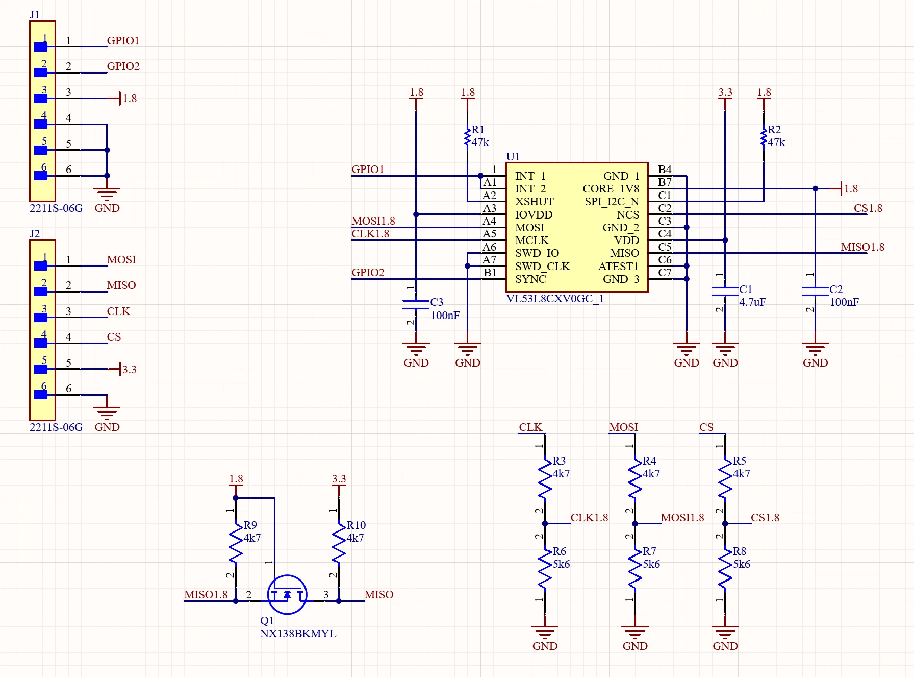

I'm trying to get the VL53L8CX ToF sensor working for a university project, this is my first time using it. I made a little breakout PCB for it and soldered it, measured resistance between al neighbouring pins, none of them were shorts or open circuits which to me confirms that the sensor was soldered correctly. The breakout PCB includes 1.8V <-> 3.3V level shifting, here's the full circuit diagram:

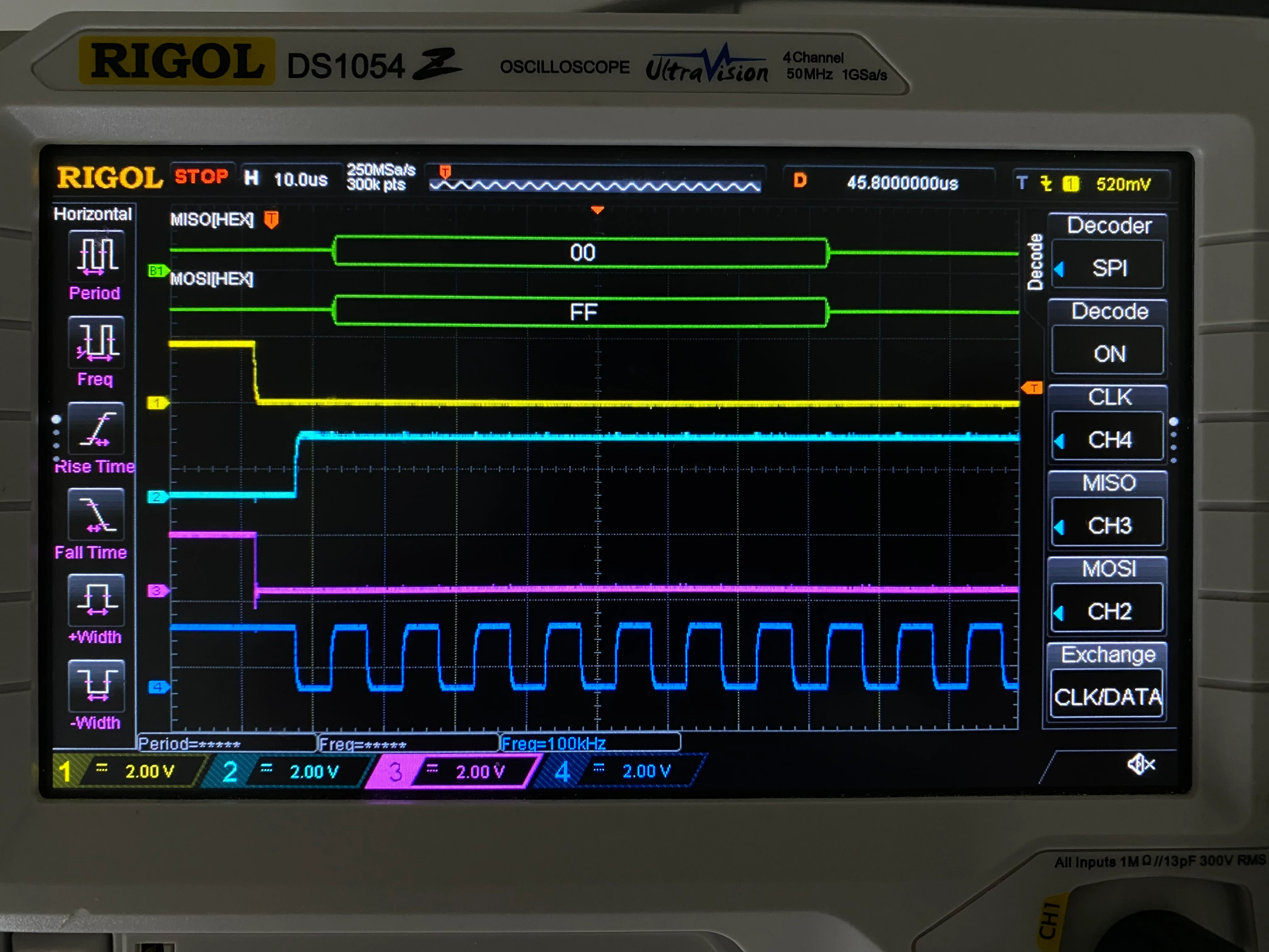

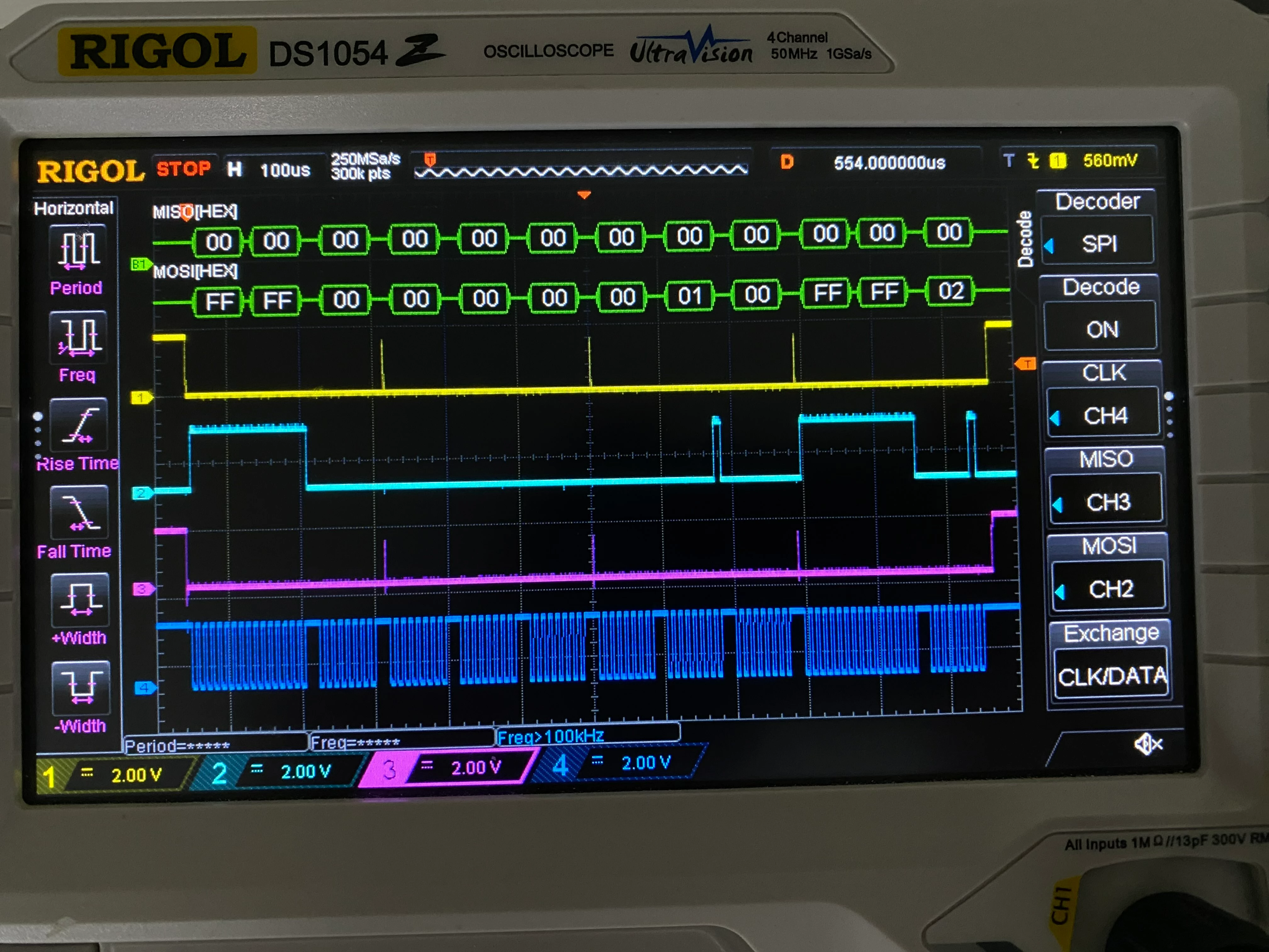

I've connected it to an ESP32, but it seems like I can't communicate with the sensor over SPI. As I understand, the sensor should be mirroring the given register adres from the MOSI pin to the MISO pin, but there's no activity on MISO, the signal just seems to follow the CS signal. Here's what the waveforms look like, measured at the sensor (1.8V) side of the level shifters:
Zoomed in:
Here's the code:

I'm going to make a guess here.
in ST's API, there is a platform.c - and it's basically empty.
We ship a completed on in our example directory, but the one in the main bit of code is empty.
it's your job to fill that out for the MCU you are using.
ST has it own STM32 processors we think you should use - and we aren't about to ship ESP32 code.
But it should be an easy matter to go to github.com and find some ESP32 SPI basic functions.
Use that to fill out the functions in platform.c
Then I think it's going to work better.
As a software guy i might suggest print out your status after your is_alive() call. I'm pretty sure it's going to tell you that the IO failed.
- john

Looking at the waveforms, it's clear data is being sent to the sensor but it's not replying anything. Do you think this is expected behaviour due to an error in the software, or might it be a hardware issue?
