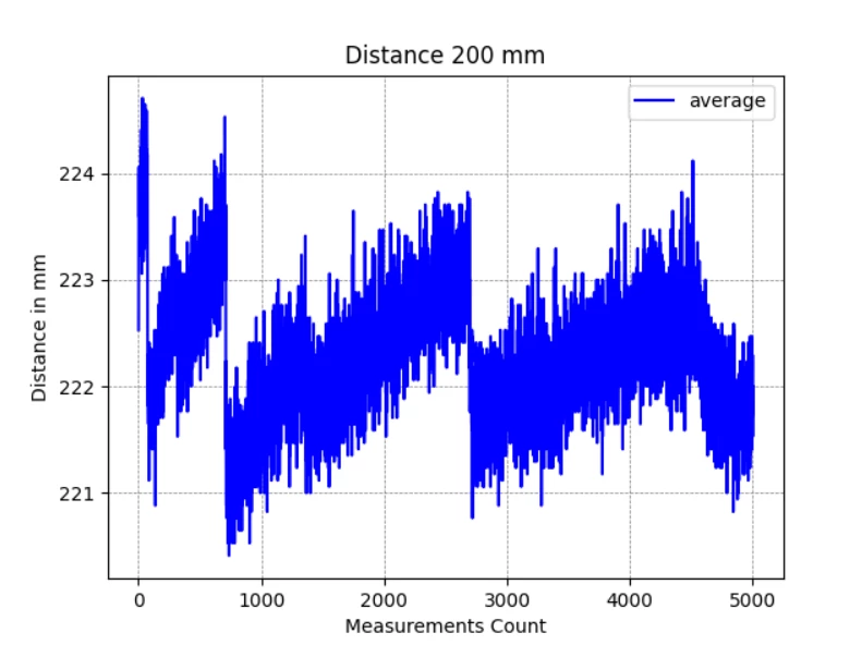

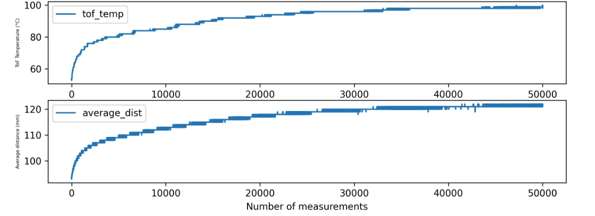

Can I ask for one more detail? I found the solution with autocalibration from this topic:
https://community.st.com/t5/imaging-sensors/disabling-vl53l5cx-autocalibration/td-p/53834
You also provided information there about autocalibration done by ToF itself. But Should it be done with some configuration? Because I had drifting anyway, so I created a wrapper with checking temperature for diff and did stop/start operation. Here results with my wrapper and without.
Standard procedure after initialization, and functions:
vl53l5cx_start_ranging
vl53l5cx_check_data_ready
vl53l5cx_get_ranging_data
With my correction
