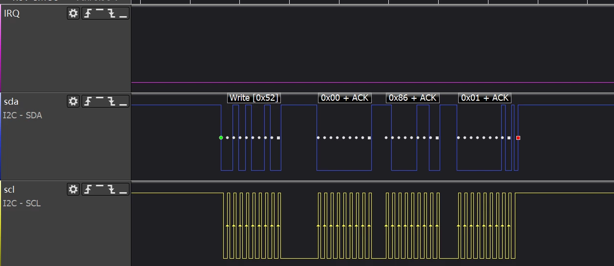

As shown in the figure, VL53L4CD_ClearInterrupt was called, but the interrupt pin still is at a low level. I have tried that under normal circumstances, after calling VL53L4CD_ClearInterrupt, the interrupt pin will become high level
John E KVAM
June 12, 2025
I think I've seen that. There is a trick. One has to clear the interrupt, then issue the stop command. If you issue the clear interrupt while the ranging engine is stopped the engine is not paying attention and you end up in this situation.
But it's trickier than that. Unless you have the absolute latest driver the stop as implemented is "stop after the current range completes". And that could be 20ms AFTER you issue the stop command. And after that last range, the interrupt will be triggered, and you can't clear it - because the engine is now stopped.
The solution is to get the latest driver. We implemented the stop as "abort the current range and stop."
Thus, you can get the interrupt, read the data, clear the interrupt and 'STOP NOW'. The engine will halt without completion of the current range, and it will not trigger that last interrupt.

Blue666Author
June 16, 2025
Could someone help me check if there are any problems with my code?
Is it necessary to add a call of VL53L4CD_ClearInterrupt before the call of VL53L4CD_StopRanging to avoid this problem?
John E KVAM
June 16, 2025
if you don't clear the interrupt before stopping the sensor will consume some power pulling that interrupt line low.
So clear it, then issue the stop, and as discussed, use the latest driver.
if you find you issued the clear and it didn't clear, then you've somehow lost communication.
the I2C is not a very robust bus. and noise can stick it.
Check to see if either the clock or data line is stuck low - that is a common symptom.
if so, stronger pullups might be required along with all the other noise reduction techniques.
- john
