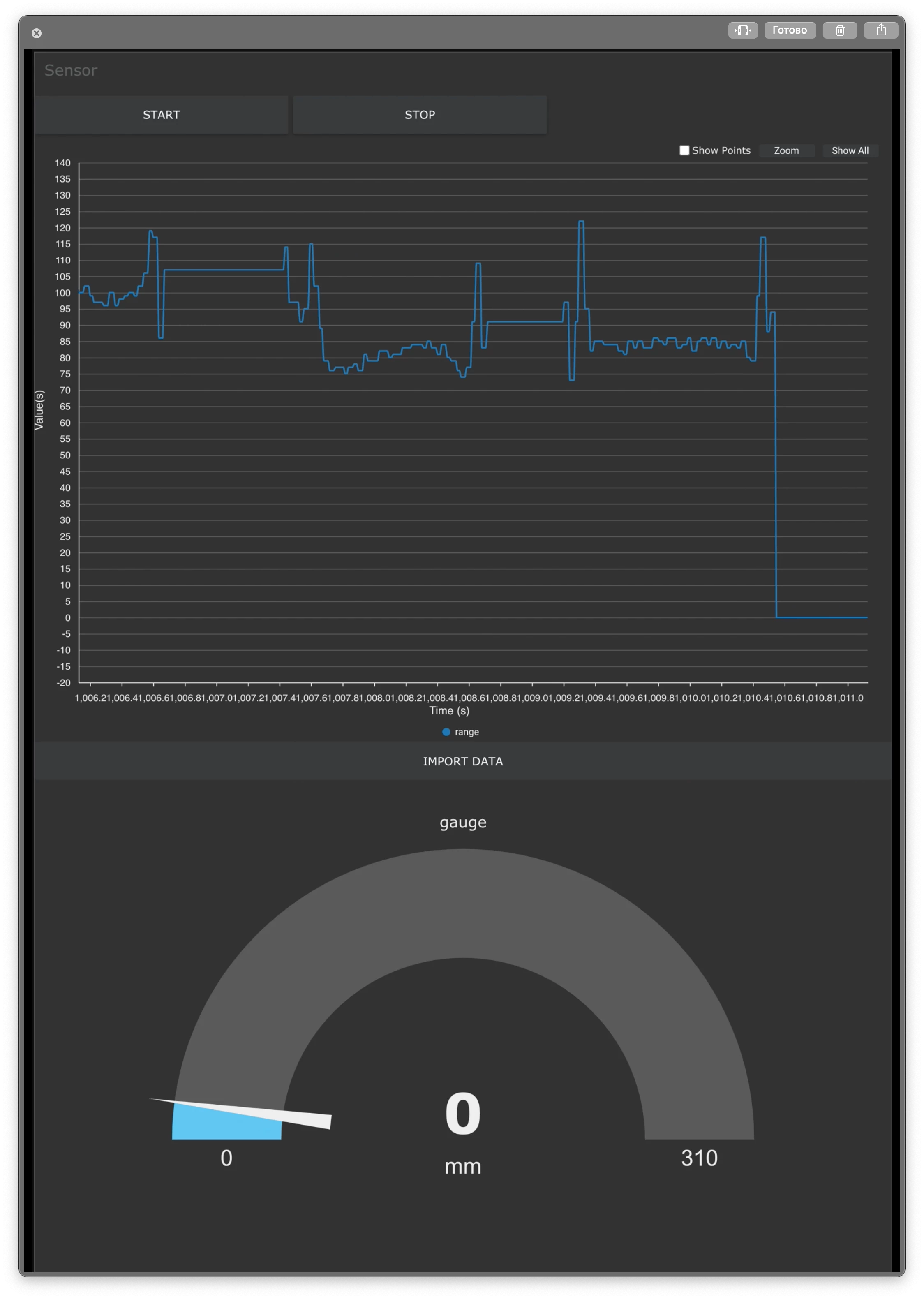

Strange behavior of the VL53L0CXV0DH sensor.
I get the correct data (distance to the obstacle), with a normal change in the position of the obstacle (zoom in / out), the data changes correctly and corresponds to the real distance.
If the obstacle is sharply removed from the "field of view" of the sensor, I get 0 (or very small, 0-25mm, values), although it is logical to get infinity. I can’t understand, is this the usual behavior of the sensor, then I will make a code check or is it some kind of problem with my sensor?

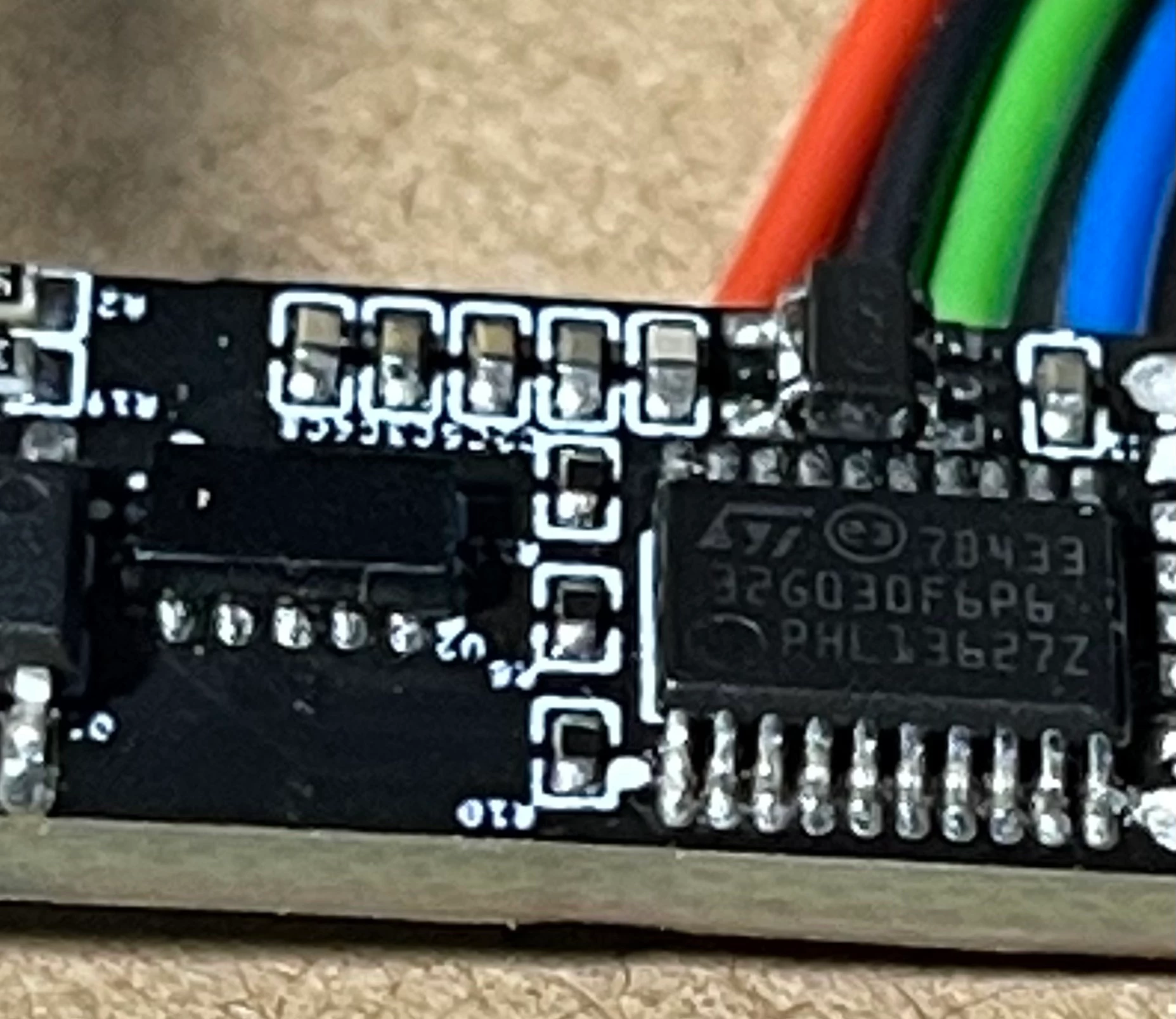

Before that, I used sensors soldered on the board and did not encounter such behavior. The described situation occurs on the board of my PCB ordered in jlcpcb, but once again I will pay attention, most of the data is correct! This baffles me.0693W00000Lwh1bQAB.png0693W00000Lwh1WQAR.png

What you are seeing is a 'ghost image'. You are getting a distance you are not supposed to see.
There are some reasons for this.
1) The coverglass is not calibrated. Light from the sensor hits the cover glass and return immediately. These photons get averaged in with the ones that hit the target, and you get a reasonable answer.
But when you remove the target you are left with only the errant photons. And they return a value.
solution is to run the crosstalk calibration.
2) Something is still in your field of view. The sensor 'detects' objects within a code of 27 degrees. But the transmitted light does not fall off immediately. So if you have a reflective object just outside that FoV, it might return enough photons to give you a ghost target.
The solution is to set the minimum signal rate. This is generally 1.5 times the crosstalk you have and is configured when you do the crosstalk calibration. But you can change.
First thing to do is compare the signal strength to your real signal. Is it much, much less? You can use a number 1.5 times that as your lower limit.
-john

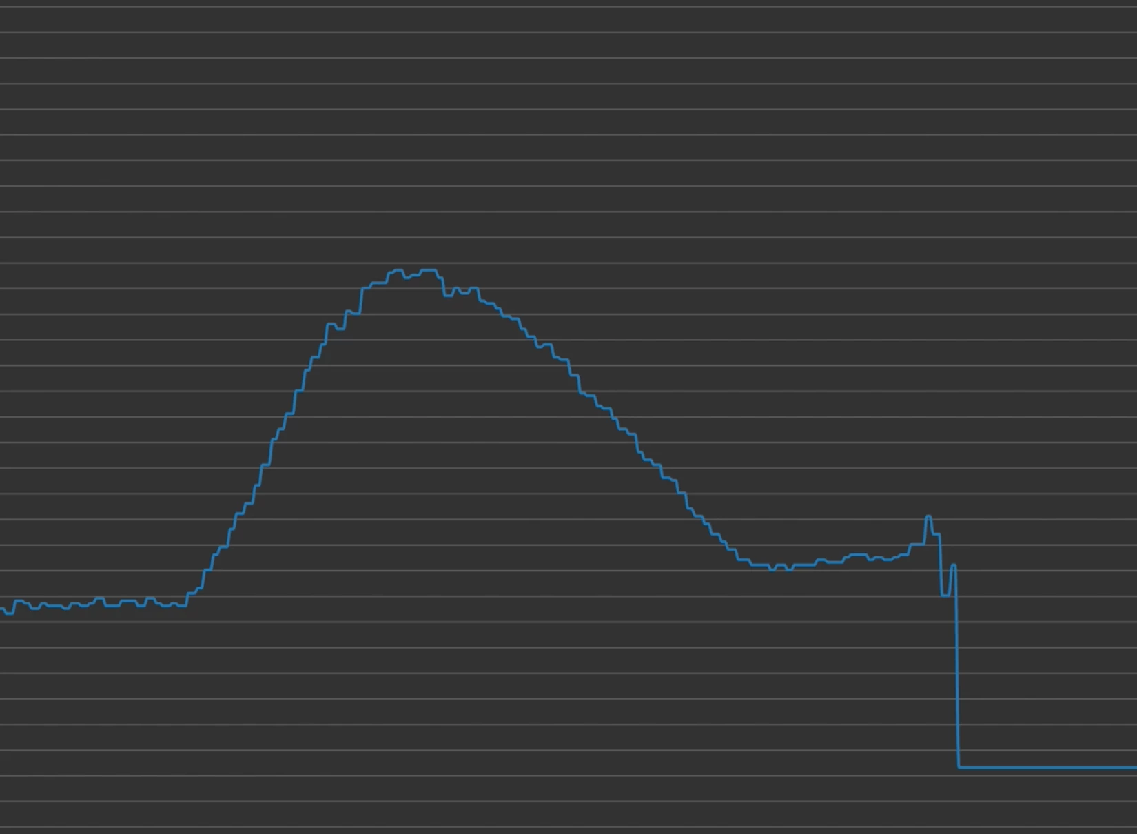

Hi John, thanks for your reply.
I don't use a cover glass, it's a prototype, it sits on my desk and doesn't need protection from dust or dirt, that is why I am perplexed.
Your second version is better for my case.

While everything was as a layout, I also thought that I didn't need calibration. I corrected the strange millisecond data tending to zero by simply putting the data in a circular buffer, comparing and ignoring atypical data. But as soon as I put the glass down, and the essence of the project is that the sensor should stand behind the glass and measure the distance, I immediately got something completely different from the truth. So I have one way - to deal with calibration.

A 4mm glass is extremely thick. And is the root cause of your issues. You have accounted for the crosstalk, but since so many photons are reflecting off that glass, you don't have enough left over to do what you want.
You can prove this by putting that glass down on the Evaluation kit and trying it. As we know our code works, it will give you the best performance you can get. But I'm thinking you will be unsatisfied.
The only solutions I can think of is to thin the glass, or switch sensors.
Both the VL53L3CB and the VL53L4CX, will fit perfectly. but they are more expensive.
They use a different bit of code that is immune to crosstalk over 80cm. and as this logic is more sensitive, I'm thinking they will work for you.
If you have fifty dollars, buy the X-NUCLEO-53L3A1 or the X-NUCLEO-53L4A2 and test them on the Nucleo F401RE you already have for your VL53L0X Eval kit. Proving it works before you get very far is the key.
