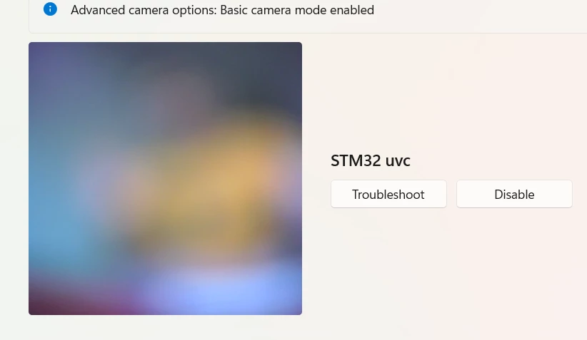

Hello Team,
I am using the STM32N657x0-Q Nucleo board with the STEVAL-66GYMAI1 (VD66GY) camera board connected via FFC. Both CN8 and CN10 are connected to the PC, and I am viewing the camera stream through UVC.
I tested the official precompiled HEX files from:
  • X-CUBE-N6 Camera Capture
  • STM32N6 Getting Started Object Detection
In all cases, the image is heavily blurred. Objects appear relatively clear only at approximately 1–2 cm from the lens, while anything beyond that distance becomes significantly out of focus.
I attempted to adjust the M12 lens focus across its full rotation range, but no noticeable improvement was observed. The same behavior occurs with multiple example projects and unmodified hardware.
Could you please advise which of the following areas is most relevant to investigate?
  1. Camera board compatibility with STM32N657x0-Q
  2. Sensor/lens configuration in the example firmware
  3. Lens focus or alignment issue
  4. Defective lens or hardware issue
  5. Recommended reference project/configuration known to produce a properly focused image with STM32N657x0-Q + STEVAL-66GYMAI1
Since the VD66GY datasheet specifies a focus range from approximately 28 cm to infinity, I would appreciate any guidance on why only objects at 1–2 cm appear sharp in my setup.
Thank you for your support.

Board: NUCLEO-N657X0-Q
Camera: STEVAL-66GYMAI1
Example: X-CUBE-N6-CAMERA-CAPTURE
Result: UVC stream works, sensor detected, but image is uniformly blurred at all distances
Tested: official Nucleo HEX files, same result

Hello Debug 123,
i suspect two things wrong reference of lens in the package or defective lens could you share us a picture of the setup ?
Thanks in advance

ldecicco
Visitor II
Aug 3, 2026 7:35 PM UTC
I have the same issue, the shipped lens is not the one advertised in the datasheet, it has a VERY short depth of focus (basically with the lens fully screwed the only way to get an in focus image is to get the lens at < 1 mm from the object).
Debug123Author
Aug 8, 2026 10:35 PM UTC
Yes, i tried the same. When the lens is < 2mm from the object i get better picture. I also tried moving the lens closer to the camera sensor, in this way you get clear image of the object kept even > 30-40 cm from the lens. But for that you need to use a lens mount with less height.

Since the same issue occurs with multiple official firmware examples, I’d first suspect the lens/module rather than the software. If it’s only sharp at 1–2 cm despite the stated 28 cm–infinity focus range, check the lens seating, focus mechanism, and consider testing another VD66GY module. Firmware configuration is worth verifying, but it’s unlikely to cause this specific optical behavior.
Debug123Author
Sep 5, 2026 12:14 PM UTC
ST has confirmed, that the lens shipped to me was not the correct one.
