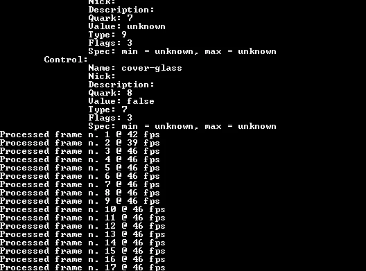

Aug 22, 2026 8:42 AM UTC
Hey, how is the latency of this sensor? does it come around 10ms like datasheet says?

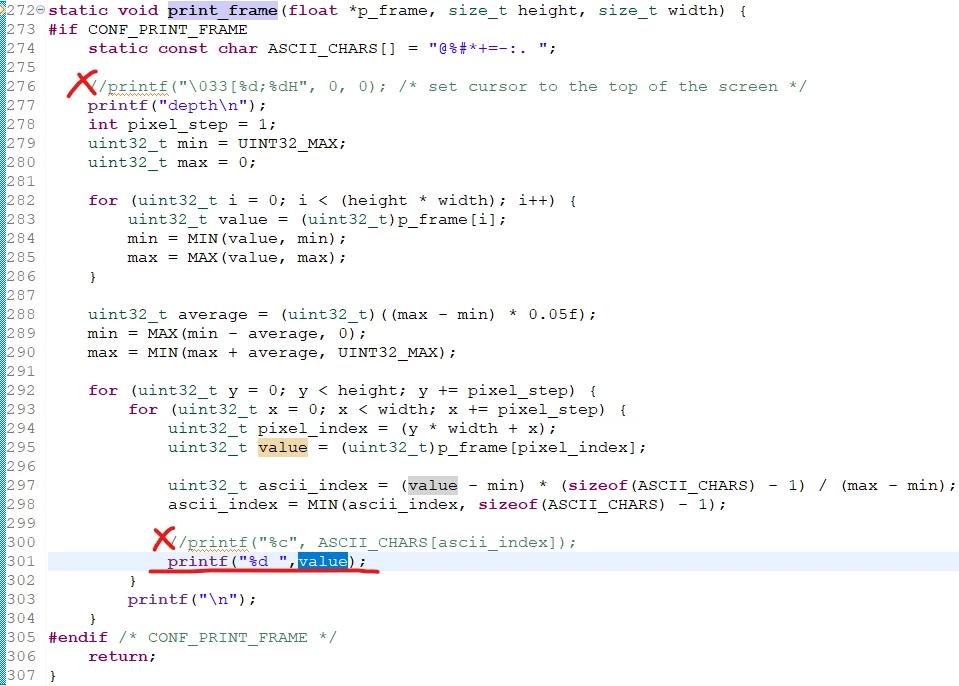

I am in a similar situation. I purchased  X-NUCLEO-53L9A1 with NUCLEO-H563ZI as it was recommended by ST. I just want to load the binary and see a simple ranging output value array. The binary provided didn´t work. Now it seams like they recommend  Nucleo N657X0. Could please someone clarify what board should I use so that there is a working binary provided?
Aug 14, 2026 8:51 AM UTC

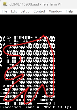

Hi:
I download the driver X-CUBE-53L9A1 | Product - STMicroelectronics, L9 with STM32H5 platform.
and build and flash the example application. it runs ok
if you set CONF_PRINT_FRAME to 1, and place my hand in front of the sensor, it shows as below pic:
if you want to check the detailed distance, please refer to below pic, then you can get what you need.
Best regards,
