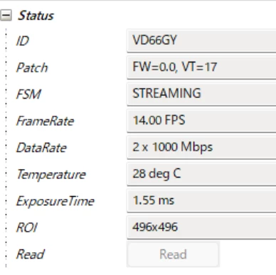

Thank you for your prompt reply. I retried with the bitrate of 1 Gbps and lower as your instruction. But still the video streaming was not achieved. The software version is 1.1.2 that seems to be the latest version. The screenshots of the image sensor status, the excution rate, and the register value of 0x030c are attached. The data rate on the sensor status was still 2 x 1000 Mbps even after I changed the register value of 0x030c for the single-lane operation.
I'll be happy if you give me further advice to resolve this issue.

Mar 6, 2026 2:18 PM UTC
After rechecking yes is impossible the EVK don't take into account the new data lane number i have request a change for new version scheduled in May.
