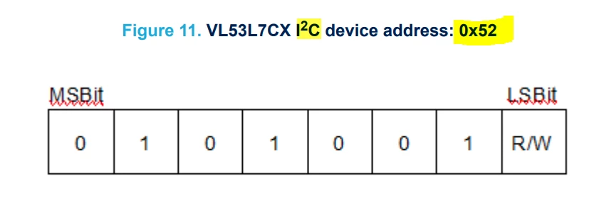

The chip is programmed to respond to a particular address. In this case it's 0x52. You don't get to pick what address you use.
August 29, 2023
This is what I did in the first place, I initialized the sensors without specifying any address in order to use the default one. But in this case, the code is "blocked" at the 1st sensor being initialized: no value (0 or different from 0) is never returned by init_sensor().
