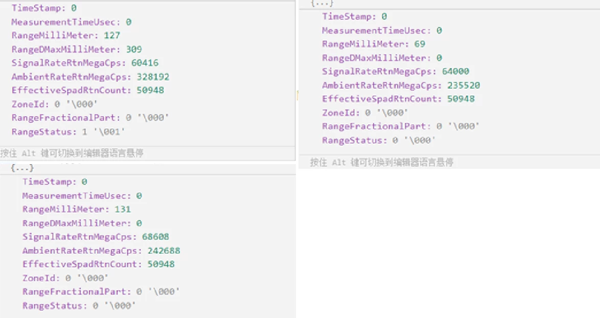

Jul 14, 2026 5:25 AM UTC
Dear  Bin :
      When there are no obstacles ahead, abnormal values may sometimes be displayed, as shown below,Why is the value of SignalRateRtnMegaCps so high when there's nothing ahead?

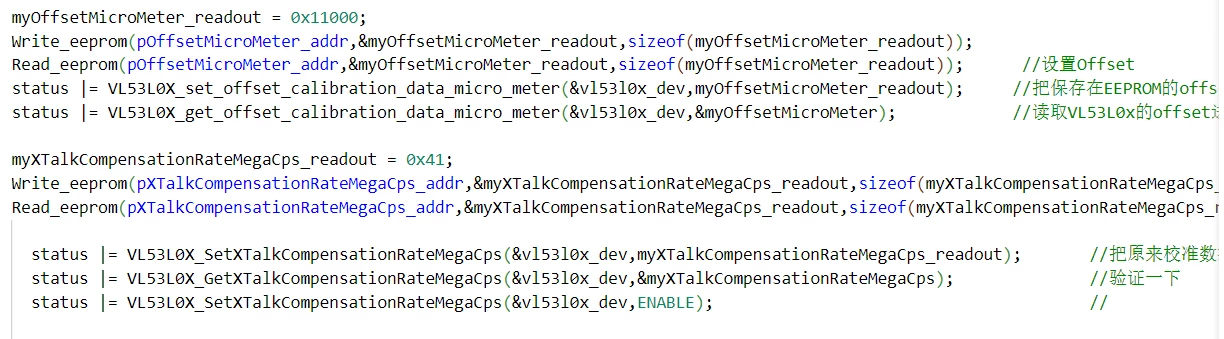

What do Signal Rate Return Mega Cps, Ambient Rate Return Mega Cps, Effective Spad Return Count mean? What are their ranges? The data we're currently receiving shows refSpadCount = 8.
signalLimit = 0.8 × 65536; sigmaLimit = 40 × 65536; timingBudget = 3300; preRangeVcselPeriod = 18; finalRangeVcselPeriod = 14. I used continuous timing mode with an interval of 1 second.
Jul 17, 2026 9:43 AM UTC
Hi:
SignalRateRtnMegaCps: this value is the return signal rate in MegaCountPer Second (MCPS). The signal value returned by the target object.
AmbientRateRtnMegaCps: this value is the return ambient rate (in MCPS). The intensity of the background ambient light

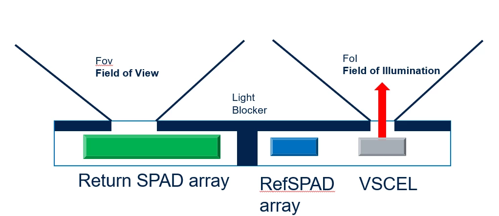

EffectiveSpadRtnCount: this is a16-bit integer that returns the effective SPAD count for the current ranging.
Normally:
the blue part means refSpad.
The number of SPADs is calibrated during the final module test at ST. This part-to-part value is stored into the NVM and automatically loaded into the device during bootup.
This calibration allows the number of SPADs to optimize the device dynamic to be adjusted.
However, adding a cover glass on top of the module may affect this calibration. ST recommends that the customer performs this calibration again in the final product application.
The green part means return SPAD (EffectiveSpadRtnCount : The actual number of SPADs involved in effective measurement in distance measurement)

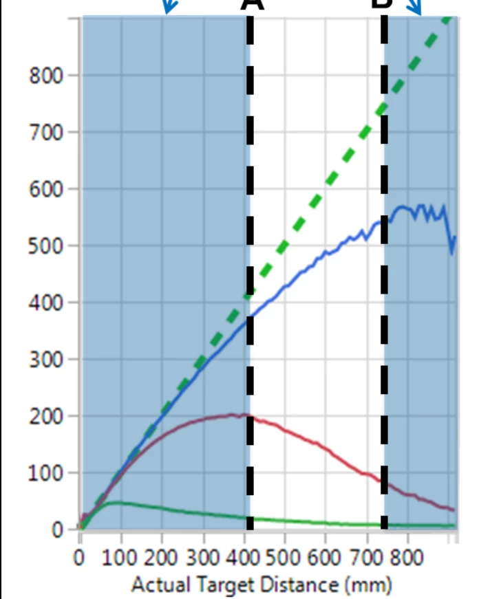

  How should I determine the XTALK calibration distance: using the factory-default RefPAD and offset values, or the calibration data obtained after applying the cover plate? If using the calibration data with the cover plate applied, should I set the XTALK value to 0 before confirmation?

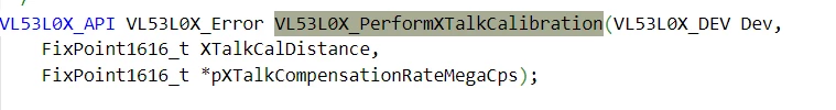

Dear Bin
Should the second argument of the function be shifted left by 16 bits for the XTALK correction distance?
Jul 17, 2026 10:00 AM UTC
VL53L0X API User_Manual.fm
According to UM2039, the XTALK calibration distance should be determined with the final optical setup in place, meaning after the cover plate / cover window is mounted.
The recommended calibration flow is:
  1. DataInit
  2. StaticInit
  3. Reference SPAD calibration (refSpadCount)
  4. Ref calibration (VHV and phase cal)
  5. Offset calibration
  6. XTALK calibration
So in practice, you should not choose the XTALK calibration distance only from the factory-default bare-module condition. It should be based on the ranging behavior of the final system with the cover plate installed.
Regarding your second question:
there is no need to manually set the XTALK value to 0 as a mandatory API step before running VL53L0X_PerformXTalkCalibration(). However, it is better to start from a clean initialization state and avoid re-running XTALK calibration while an old XTALK correction is already loaded and active.
For the calibration distance itself, UM2039 says that the valid XTALK calibration region is where the measured curve starts to deviate from the ideal one, but before the return signal becomes too weak. The manual also recommends using:
  • a 17% grey target
  • at least 600 mm
  • covering the full FoV
And for your last point:
the second argument of VL53L0X_PerformXTalkCalibration() is in millimeters, so it should be passed directly as, for example:
VL53L0X_PerformXTalkCalibration(&vl53l0x_dev, 400, &myXTalkCompensationRateMegaCps);
It should not be shifted left by 16 bits.
Best regards,
Bin FAN

     the distance is FixPoint1616_t
Jul 20, 2026 8:12 AM UTC
Hi:
you can use hexadecimal as input parameter. For example, if you want to set 2.75.
2.75×65536=180224 = 0x0002C000
Best regards,
Bin FAN

zhyAuthor
Jul 21, 2026 3:23 AM UTC
Hi,Bin
  I wrote the data validated by Offset and XTALK into the register in hexadecimal format, and the situation improved as shown below—please confirm if correct.
