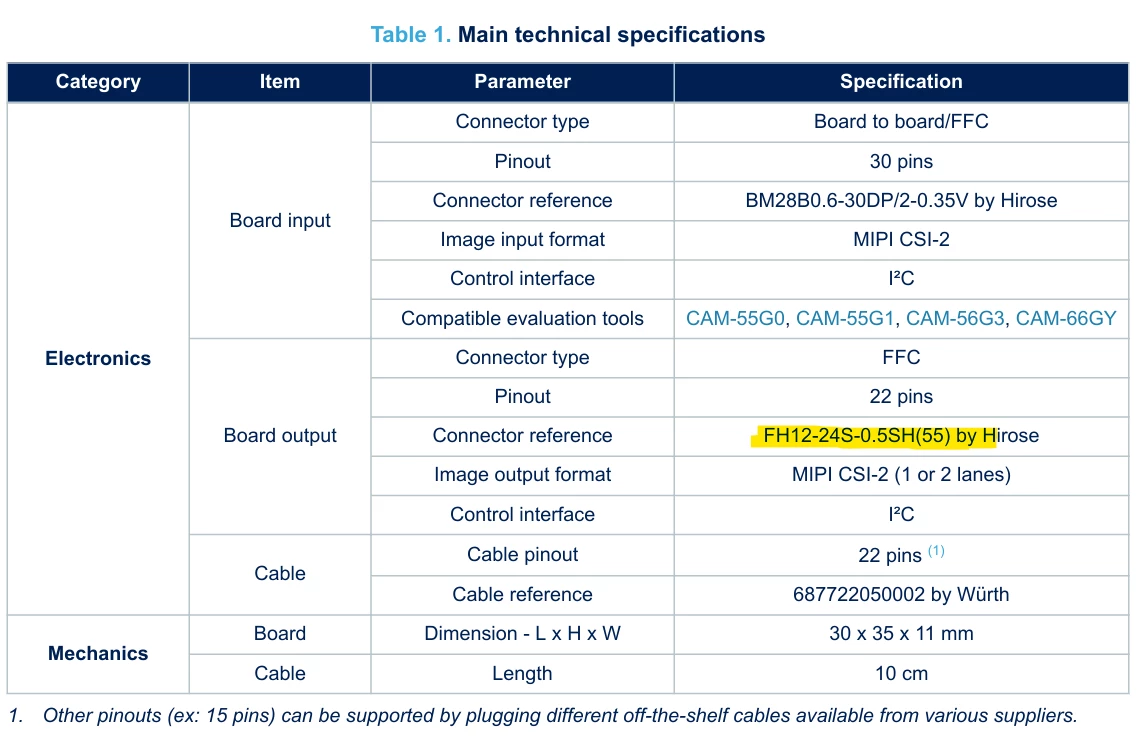

The Data Brief for the STEVAL-CAM-M0I adapter board references the FH12-24S-0.5SH(55), which is a 24-pin connector. However, the cable pinout appears to be the usual 22 pins. Is this a mistake in the Data Brief, or is there something I'm overlooking?
Data brief - STEVAL-CAM-M0I - P-Board: Hardware MIPI CSI-2 kit for the evaluation and integration of promodules on embedded processing platforms

Hi ​@wqTZ ,
Thank you for pointing this out. You are correct, the connector reference is incorrect in the data brief. This is a 22pin connector, so the good reference is FH12-22S-0.5SH(55).
Best regards,
Jean
