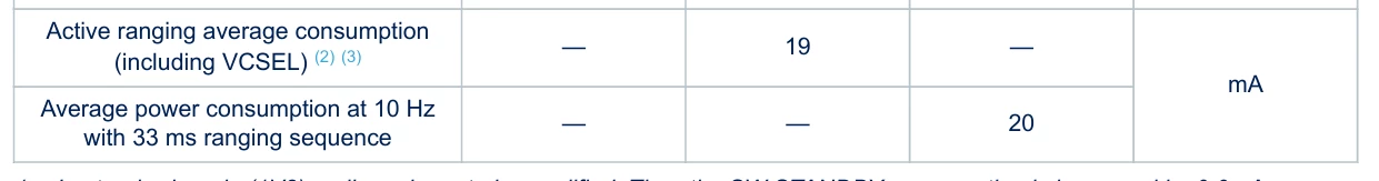

the sensors - when running - will max out at 20mA. Anything above that is a problem.
But if you only pole occasionally you can tell the sensor to pause between ranges. Use the intermeasurement period and the timing budget to set how often the sensor ranges.

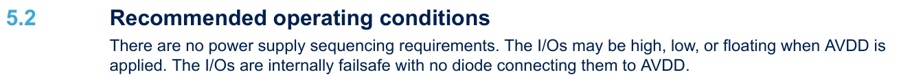

Powering the dev board and the sensors independently should cause no issues.
But pulling 200 mA does indicate a hardware issue. Perhaps something else happened.
