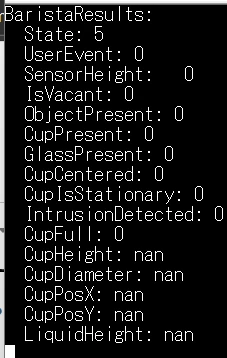

I am trying to evaluate a P-NUCLEO-53L8A1 evaluation kit. I downloaded the software example from your website and unzipped it. I then attached the eval board to a USB port on my laptop (running Win 11). It enumerates as a STLink VCP.
I then added the cup detect binary file to the evaluation board as described in the manual. The file copies into the folder specified in the user manual (also LD1 on the eval board blinks). When the copy process is complete, the folder then momentarily disappears and the re-appears with the file removed.
When I then run the Cup Detect executable I get the following error
Could you please advise how I can resolve this issue?
I also tried running the GUI on two other laptops (one using WIN11, the other WIN10). On both laptops the GUI does not launch.
Thank you very much.

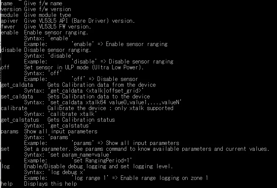

Download 'tera term' or any other serial emulation app.
Set it to:
And use an 'auto' newline as in:
hitting the black button on your Nucleo board will get it to reboot and you should see:
Do you see that?
Next type 'help' - this will give you the list of commands:
(There is no echo, you will need the local-echo feature or just live without it.)
The enable command starts it running and you get:
If this all works, then you have a PC problem.
Remember to kill Tera Term before you run the app.
