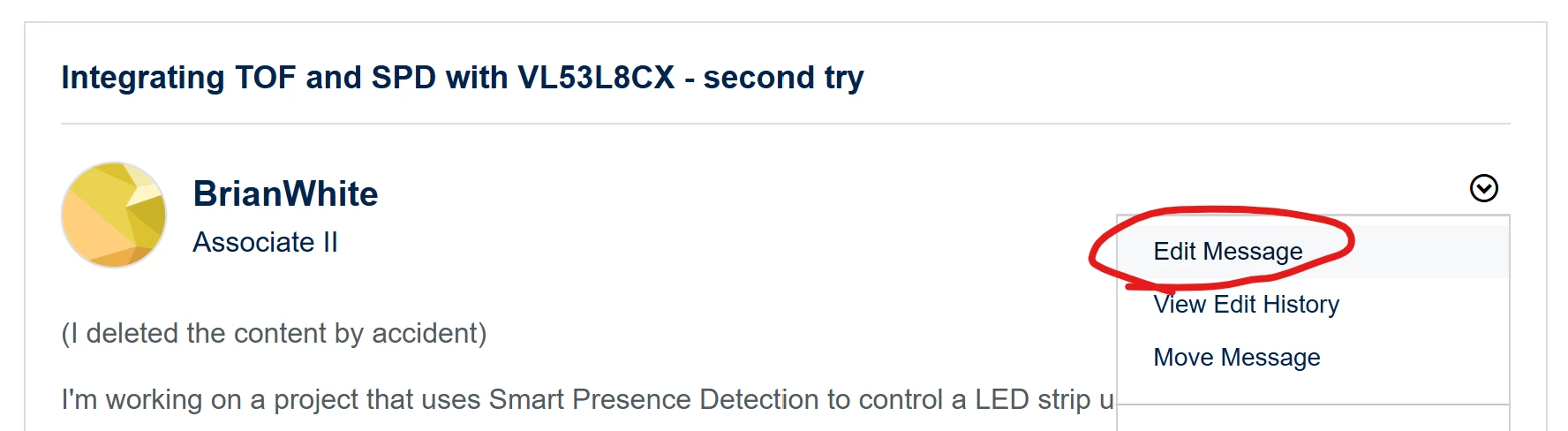

(For next time, you can edit your post here rather than reposting.)
