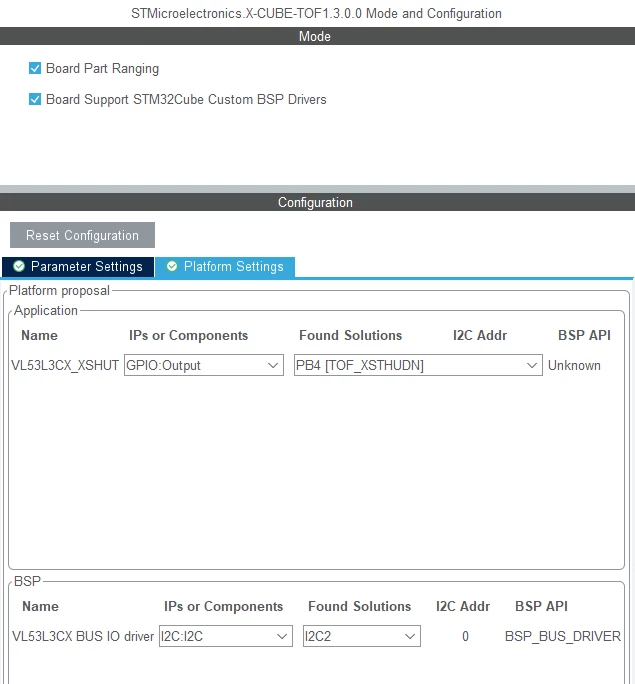

I own a small dev board (LoRa-E5 mini from SeeedStudio) and coding using STM32cube IDE + MX.
I have made project from scratch, using LED, switch, UART (works fine !)
... and now I want to use my VL53L3CX-SATEL board.
The board is defined on I2C2, all looks ok but in project nothing seems to be used ... any sample/tutorial ???
How to read any value from there ?
So annoying to getback to noob state...
Tanks for help.

If you added the X-cube-tof1 to your project, then the drivers have been added to your project.
So teh best course of action would be to download the:
STSW-IMG015
VL53L3CX API (Application Programming Interface)
Because that's where we hide the example code.
You need to make the calls like in this (simplified) example.
But the full code is in the download.

Hi, thanks for your answer.
I must be dumb but I cannot make it working ...
(if that help, my cleaned project is in the zip)
How to create the "Dev" used in ????? :
status = VL53LX_WaitDeviceBooted(Dev);
:loudly_crying_face:
Code from "STSW-IMG015" is using i2c object that I don't have since MX have link it to TOF ( and XSHUTDN GPIO too ).
I've tried but nothing works for me, each time = crash ...
I'm pretty sure my TOF device is waiting me somewhere in my project ... arrrgggghhhhhhhh ...

To be more precise : I have added&setup 2 packages in my project.
In my MX 's project >> Software Packs >> STmicroelectronics.X.CUBE.TOF1.3.0.0 Mode and Configuration I have :
☑�? Board Part Ranging
☑�? Board Support STM32Cube Custom BSP Drivers
Thanks for help.
Sebastien.
