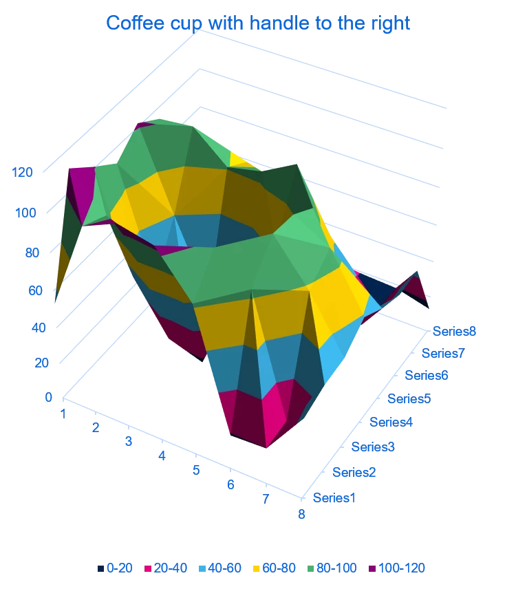

The VL53L5CX - due out in June (probably the last day in June, though) is what you want.
The picture below was taken with one.
It gives you a 8x8 image, 15 times per second.
Here the sensor is looing down into a coffee cup, with the handle on the right.
0693W000008ziQlQAI.pngThe VL53L5CX costs a bit more than the VL53L1, but it's still not very expensive.
And you get a LOT more.
So if you can wait until late June you will be all set.

Thank you for your fast answer! The VL53L5CX does indeed sound very interesting and the image you attached looks very promising. However, I am worried about the suitability for our application. I immediately searched for the sensor and found marketing slides talking about a FoV of 61° (slide 10). Assuming that is the diagonal FoV, the horizontal FoV would be around 61/sqrt(2) = 43°? Meaning that objects covering less than 6° of the FoV will probably not be detected reliably. Is that a fair assumption?
In our application, we want to monitor a manufacturing area with workpieces that - given their fixed size and the slightly varying distance to the sensor - cover between 0.93° in the worst case and 8° in the best case of the sensor's FoV, so I guess it would not be detected reliably in any of the zones. Or am I misinterpreting the available information?

Well you get 2 points for getting the math right :) 43 degrees on a side is correct.
As the sensor does 8x8 you get 43/8 or about a 5 degree area.
Now you might see something that only covers only 1% of that area. Is the object particularly reflective? Or does it have a reflectivity that is clearly different from the surface on which it sits?
You don't actually have to get an exact distance to know something is there - the distance just has to be different from when the object is NOT there. And you can double check it if the reflectivity changes.
In the graph above the rim of the coffee cup was only 5mm, but the edge is clearly visable.
The good thing about ST sensors, is that you can buy an evaluation kit. Generally these are about $50. In 20 minutes you can take enough data to decide if the project is worth doing. It's a few dollars well spent.

Thank you again for your answer. The evaluation kit sounds like a really good option, we will try this sensor once it is available. We are tracking steel bolts on a plastic surface and have full control over the background. So we can line the background with particularly absorbant material, if that helps to increase the contrast in the signal.
John E KVAM
April 16, 2021
That would do it. One thing you might not know... Most plastic is translucent to 940nm light. So unless you paint your plastic surface, you might find you are ranging on what's UNDER the plastic surface. I always paint my plastic with a bit of flat black paint to avoid this issue.
