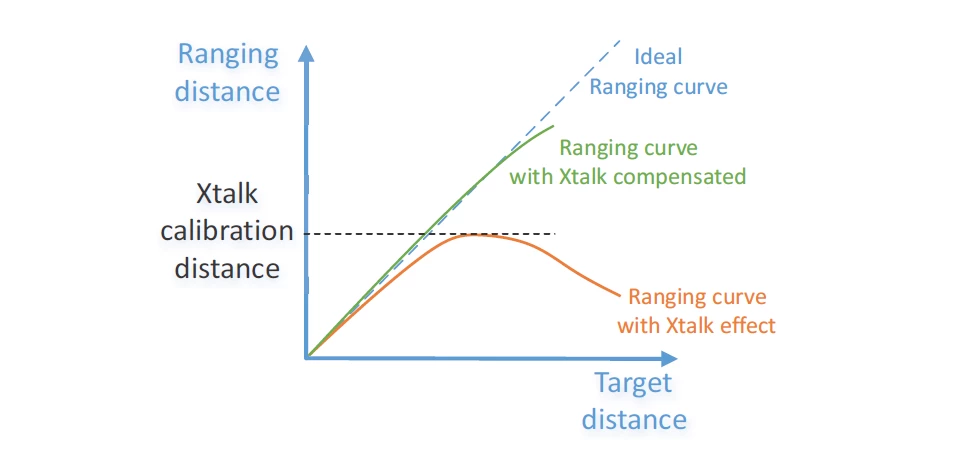

How to do the Crosstalk compensation for VL53L1X with VL53L1X ULD
I use a glass for our VL53L1X sensor. But we found there is a crosstalk problem and
have to use crosstalk compensation. We use VL53L1X ULD for our device.
There are three functions about crosstalk.
int8_t VL53L1X_CalibrateXtalk(uint16_t dev, uint16_t TargetDistInMm, uint16_t *xtalk);
VL53L1X_ERROR VL53L1X_GetXtalk(uint16_t dev, uint16_t *Xtalk);
VL53L1X_ERROR VL53L1X_SetXtalk(uint16_t dev, uint16_t XtalkValue);
Could you tell how to use these functions to compensation crosstalk affect?

Hi Dai Sai
To get correct xtalk value, you need to perform xtalk calibration,
Crosstalk calibration should be conducted in a dark environment, with no IR contribution.
Place a 17 % reflectance chart at the crosstalk calibration distance (xcd),
then call the VL53l1X_CalibrateXtalk(dev, xcd, &xtalk) to get the correct xtalk value.
Once you get the xtalk value you can save this value to your system FLASH, after VL53L1X rebooting, you need read the xtalk value out from FLASH, and set to device by command
VL53L1X_SetXtalk ().
For the clibration distance, the suggested calibration distance will be the inflection point of the raw ranging results (without xtalk compensation).
_legacyfs_online_stmicro_images_0693W00000biHM5QAM.pngFor more details, please check the guide on www.st.com
https://www.st.com/resource/en/user_manual/um2510-a-guide-to-using-the-vl53l1x-ultra-lite-driver-stmicroelectronics.pdf​
