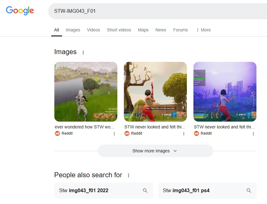

Andrew Neil
April 3, 2025
@Anne BIGOT wrote:
here you can find STM32F401 project source code
Did you mean to give a link?
Anne BIGOT
April 3, 2025
Going to the STSW-IMG043,
you can see in the get software section, some sub-package.
To get the code for F401, please upload the STW-IMG043_F401
Our community relies on fruitful exchanges and good quality content. You can thank and reward helpful and positive contributions by marking them as 'Accept as Solution'. When marking a solution, make sure it answers your original question or issue that you raised. ST Employees that act as moderators have the right to accept the solution, judging by their expertise. This helps other community members identify useful discussions and refrain from raising the same question. If you notice any false behavior or abuse of the action, do not hesitate to 'Report Inappropriate Content'
Andrew Neil
April 3, 2025
Ah yes, that works - there was a typo in your previous post:
@Anne BIGOT wrote:
For option2, the code is part of STW-IMG043_F01 sub package
