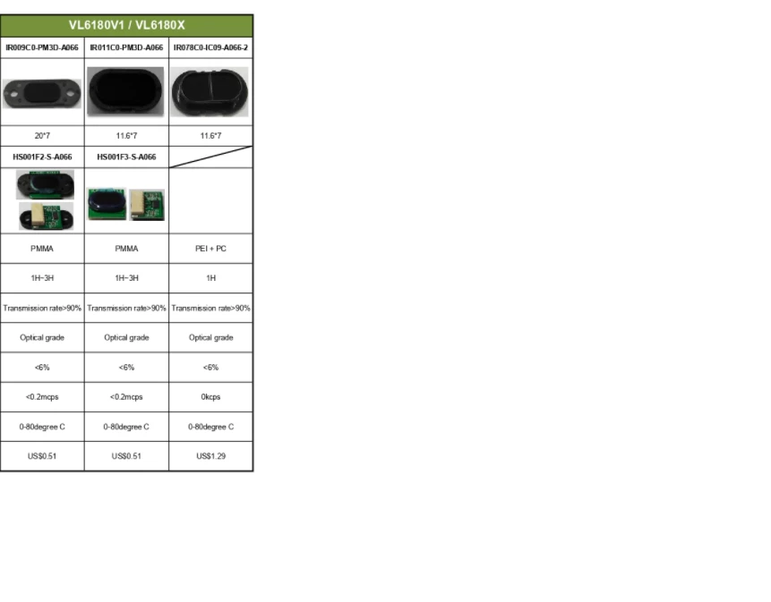

How to use this api VL6180_RangeIgnoreConfigure(), what does this parameter (IgnoreThreshold)mean, and how to determine it

Your issue is crosstalk. You must read and understand what crosstalk is.
go to:
https://community.st.com/s/article/Time-of-Flight-Cover-glass
It's a short article that will point you to other resources.
Then go to www.hornix.com.tx
This company molds optical quality plastics. They have a crosstalk free coverglass. Go to their products page and scroll almost to the bottom. Look for the coverglass that has a barrier between the Tx and Rx sides. This will keep the photons from short-circuiting the system and giving you that short answer.
Note there are 3 products - the one you want is the one on the right. That ridge is made of opaque plastic and extends all the way to the chip. It prevents the light from crossing over to the receive side no matter how dust, dirt, or milk gets on it. 0693W00000JPtwRQAT.pngYou must either use this, or invent something like it.

The easy way to solve your problem is to go to www.Hornix.com.tw and buy the coverglass with the raised barrier between the TX and the RX side of the sensor. (From the products tab, go almost all the way to the bottom).
this coverglass creates a near-perfect barrier between the TX and the RX side. If you get enough dirt on the sensor you might blind it but you will never get a wrong answer. And if you get no answer, you have to indicate to the user he has to clean the lens.
There is no real trick to the Hornix cover, except the molding of the two plastics. One clear one (to 950nm) above the optical elements and the opaque one everywhere else. That and a very tight fit is what you need.
