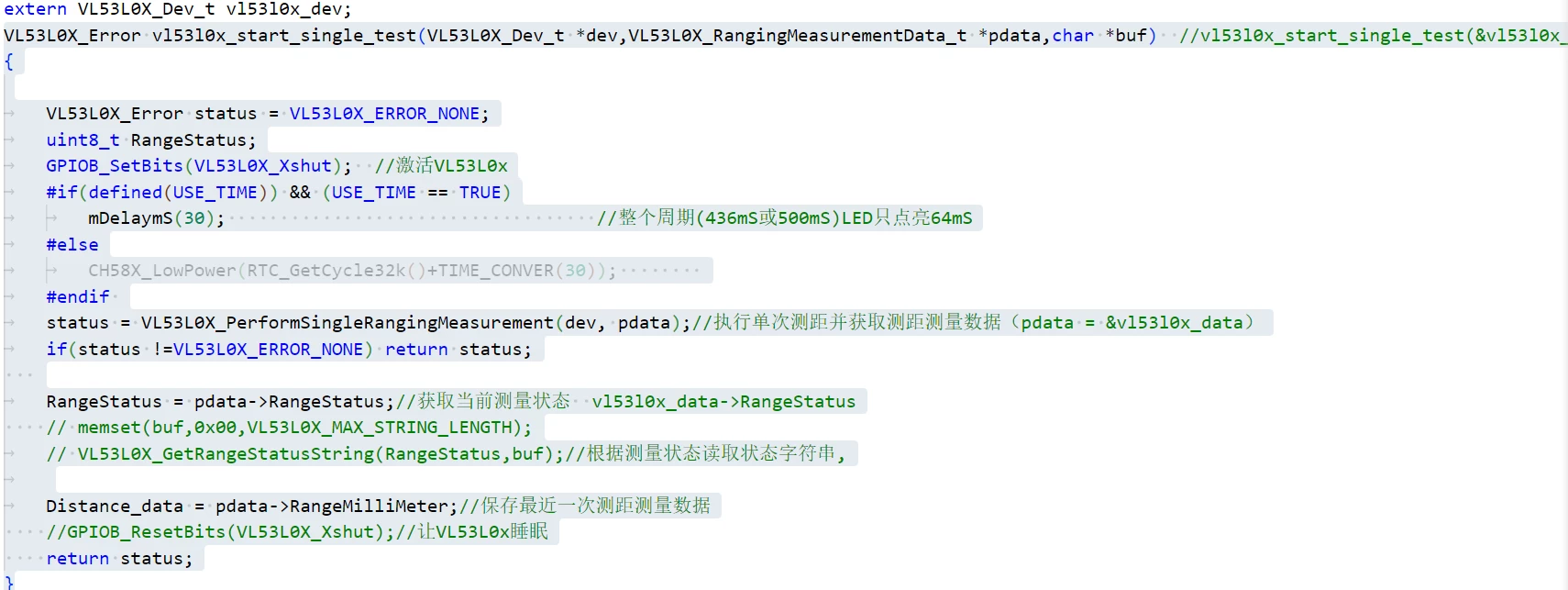

I want to reduce power consumption, but there's an error. Could you advise how to configure XSHUNT for the next measurement after lowering it?
zhyAuthor
Dec 23, 2025 8:50 AM UTC
Hi,Han
Does lowering the XSHUT really save power? I'm using a battery!
                                         thank you
Zhiyuan.Han
Dec 26, 2025 12:40 AM UTC
Hi
Pulling down XSHUT will help to set the sensor to HW standby status, and it helps to save 1uA standby current from 6uA to 5uA.
to save battery power, I suggest you disabling the power supply directly, this will be the best case.
Br
Zhiyuan.Han
