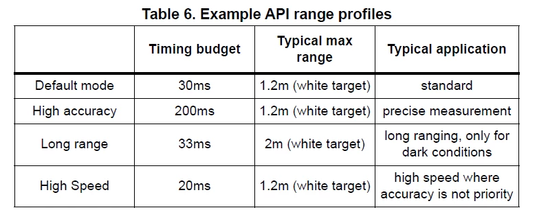

I am currently actively debugging and working with the sensor and it shows correct measurement data when i set the profile to 'Long range' example (settings from the 'um2039' User manual).
however the sensor response for RangeDMaxMilliMeter: always show a value around 1200 which should be around 2000, is there another settings which i need to do before the profile is actively set to long range?
Measurement data is now also correctly measured until about 1200mm but higher results in invalid measurements.
below are my settings as they are performed in the code:

// Configuration steps (!!!!!!!!!!!! Long range mode !!!!!!!)
// Limit check value >> 1
VL53L0X_Error configuration_step = VL53L0X_SetLimitCheckValue(VL53L0X_DEV,
VL53L0X_CHECKENABLE_SIGNAL_RATE_FINAL_RANGE,
(FixPoint1616_t)(0.1*65536));
if (configuration_step != VL53L0X_ERROR_NONE)
// Some error
g_tof_state = tof_sensor_reset_sensor;
return HAL_ERROR;
// Limit check value >> 2
VL53L0X_CHECKENABLE_SIGMA_FINAL_RANGE,
(FixPoint1616_t)(60*65536));
// Some error
return HAL_ERROR;
// Measurement timing budget
configuration_step = VL53L0X_SetMeasurementTimingBudgetMicroSeconds(
VL53L0X_DEV, 33000);
// Some error
return HAL_ERROR;
// VCEL pulse period 1
configuration_step = VL53L0X_SetVcselPulsePeriod(VL53L0X_DEV,
VL53L0X_VCSEL_PERIOD_PRE_RANGE, 18);
// Some error
return HAL_ERROR;
// VCEL pulse period 2
VL53L0X_VCSEL_PERIOD_FINAL_RANGE, 14);
// Some error
return HAL_ERROR;
// Device mode
configuration_step = VL53L0X_SetDeviceMode(
VL53L0X_DEV, VL53L0X_DEVICEMODE_SINGLE_RANGING);
// Some error
return HAL_ERROR;

John E KVAM
November 8, 2023
Dmax is the most mis-understood range result.
But say you had a lot of ambient light - and saw basically nothing. Dmax says "in these light conditions, I could only 'see' this far." Which means if you DMAX was 1.2 meters and you had no target the sensor could guarentee that there was nothing up to 1.2 meters.
If you have a target DMAX is kind of meaningless.
The intent was for a autofocus application. With no data to go on, where whould you start the focus operation.
Just start at DMAX and see if the camera can use it's algo to focus. But you don't have to search for focus points below DMAX.
-john
If this or any post solves your issue, please mark them as 'Accept as Solution' It really helps. And if you notice anything wrong do not hesitate to 'Report Inappropriate Content'. Someone will review it.
RBerk.1
RBerk.1Author
November 8, 2023
HI John,
Thank you for your reply, i was under the impression that DMAX was the max amount of distance the sensor could detect with the given settings. (e.g. for long range profile this would then be higher).
Then ill change the softwares implementation of DMAX.
furthermore, our problem turned out to be a HW issue with our cover glass, without it and the above code/settings the sensor can measure beyond the 1,2m.
I was expecting DMAX to show a value of about 2000 so that threw me off in searching the problem.
Kind regards,
Richard
