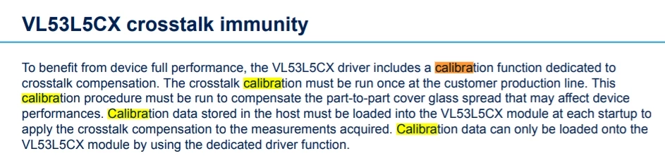

cover glass vl53l5cx
by using the cover glass can the sensor still able detect close ranges (after calibration)
Issamos
IssamosBest answer
September 6, 2023
Hello @tarlan
the sensor still able detect close ranges using the cover glass after calibration. For more information, you have to take a look to this application note:
Where you can find answer to all your questions including the calibration issues.
For more information, take a look at this link.
Best regards.
