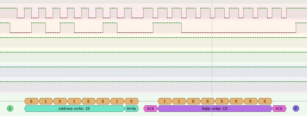

Ive tried to write a simple byte to the Sensor but all it does is pulling SCL and SDA down right after transmitting the last digit (write). It doesnt even give an ACK and it willbe pulled down until i cut the power supply.

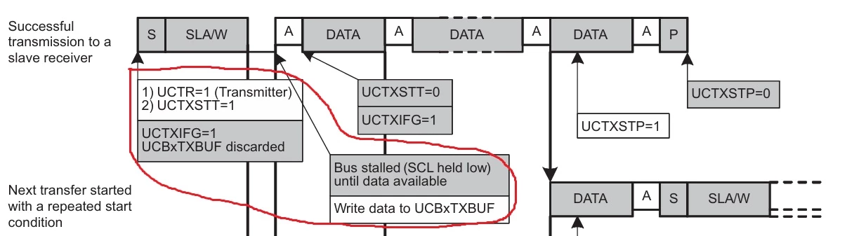

Id like you to inform, that the only Problem here was me.
I didnt read the Usermanual carefully of my Microcontroller trusted other sources on how to write the TX Buffer. It turns out that my Controller discards the whole Buffer and waits until it is writen (the Microcontroller pulled the SCL line). Ive always wrote to the Buffer before waiting for the Startbit to be set. Ive changed the position so that i write to the buffer after waiting for the Startbit to be set. I use the MSP-TS430RHA40A package if anyone is interested

Successfully written a ByteSuccessfully written a Byte
