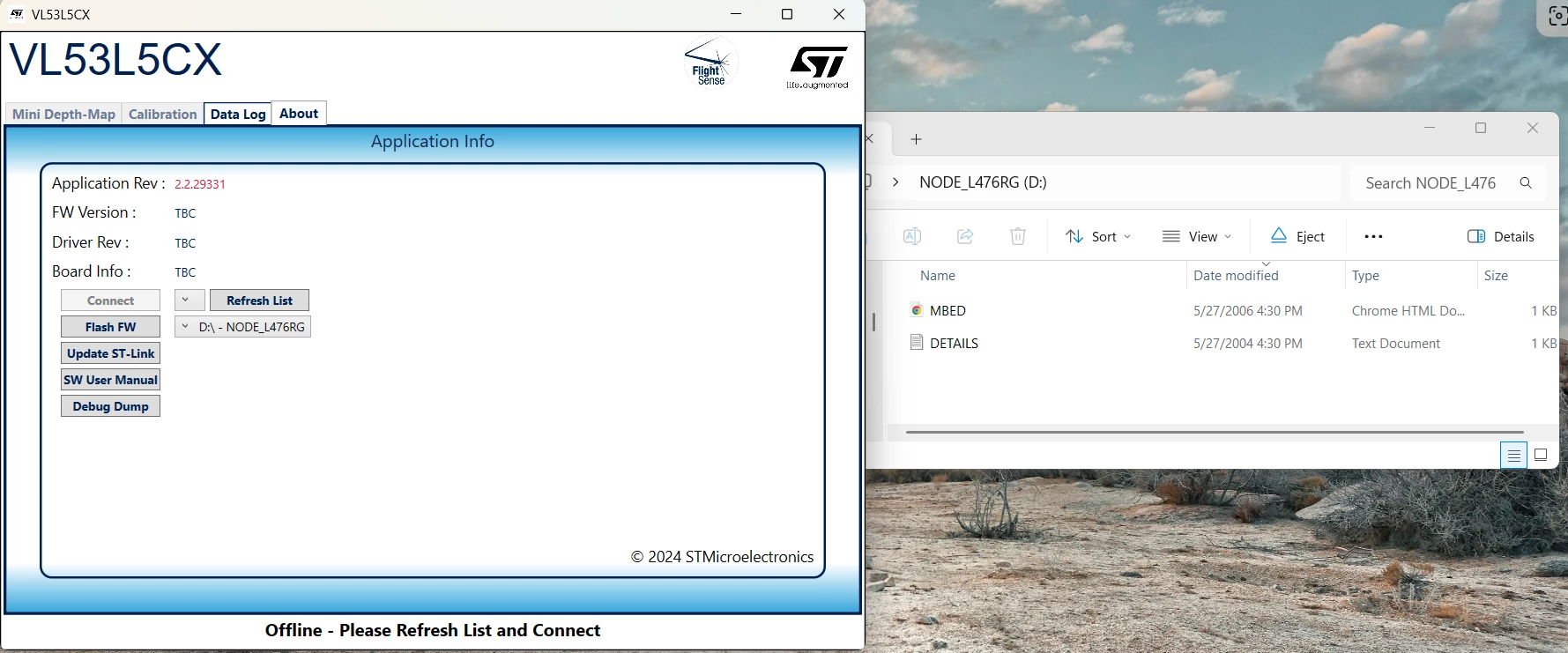

I Can't Connect to X-Nucleo-53L5A1 board & Nucleo-L476RG in order to run the "VL53L5CX GUI Software"
Firmware and driver installed properly according to the manual, but can not get it to connect.
Do I have to use the STM32-F401RE board to get the software to connect?

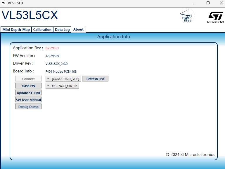

    Hi:
    By default, X-Nucleo-53L5A1 board is developed with STM32F401, and pin connection is matched. so run GUI and flash fw into your L5 with Nucleo-L476RG can’t run.
