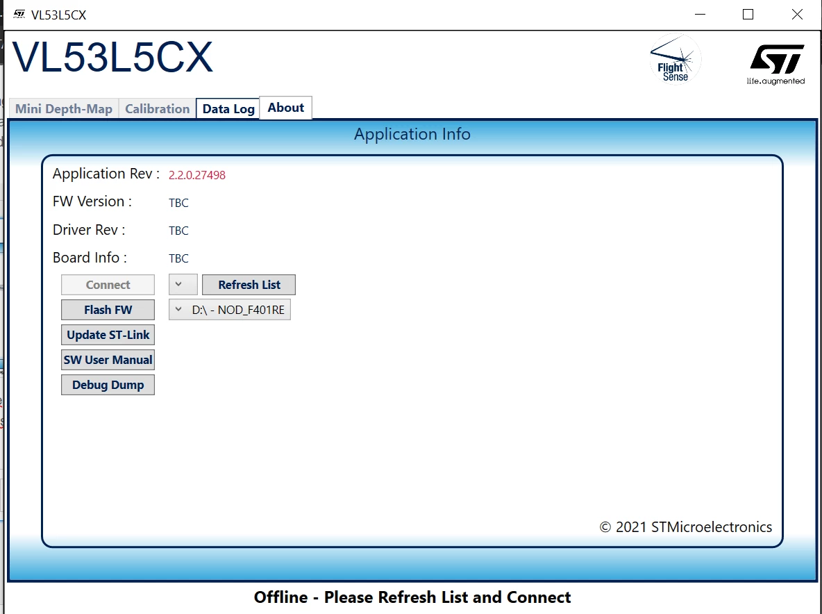

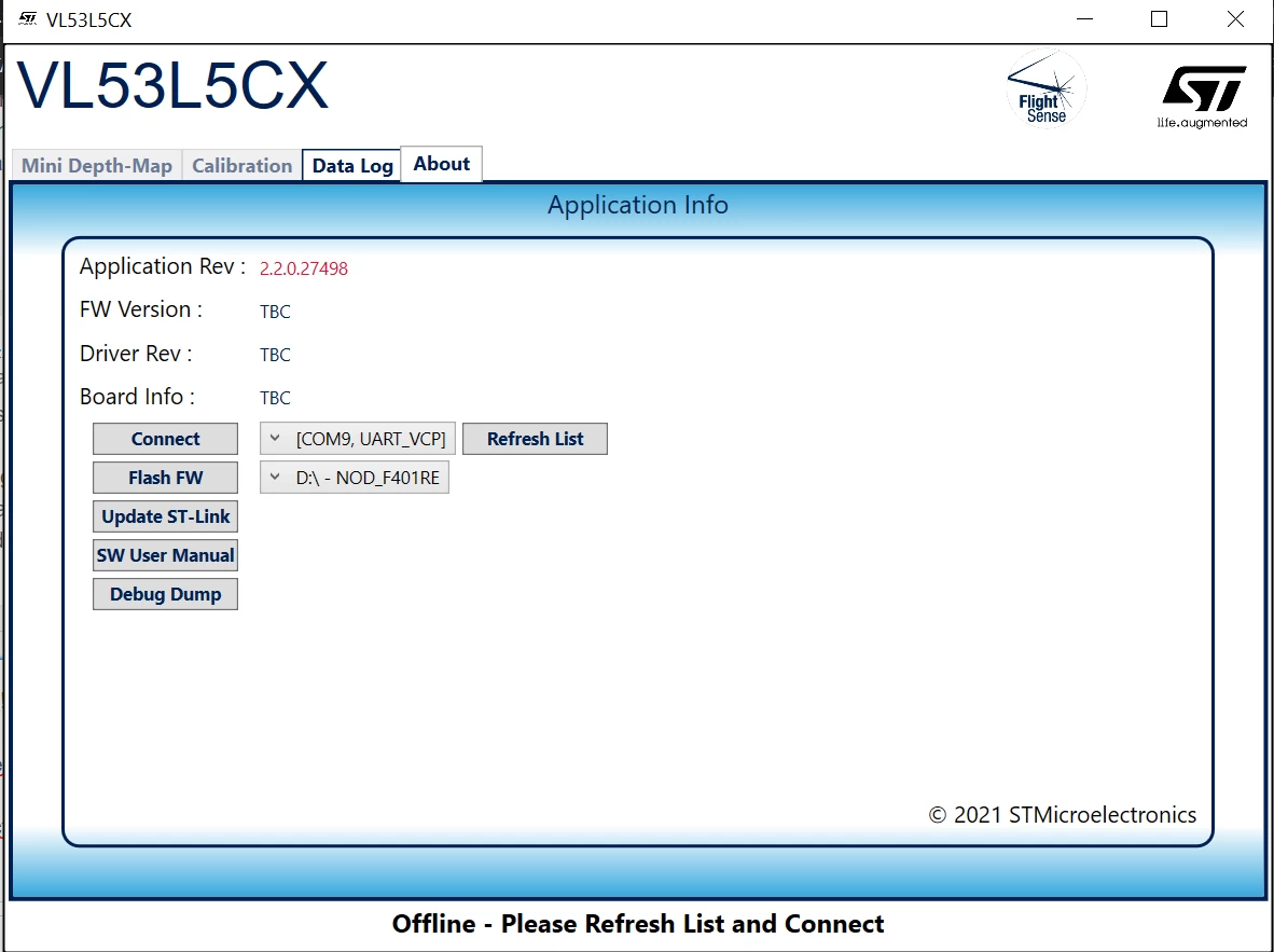

FLaba.1
Visitor II
October 6, 2022
Hello everyone!
I want to connect the STM32F401 + X-NUCLEO-53L5A1 to the GUI and I find the following problem.
If I only connect the STM32F401 through the USB port, the screen tells me the following:0693W00000UnUcmQAF.pngBut, if I add the X-NUCLEO-53L5A1 expansion board, it automatically stays in this state, without letting me press the "connect" command:
0693W00000UnUdkQAF.pngCould someone recommend me some help?
Thank you all
John E KVAM
October 7, 2022
When the software sees the expansion board, it wants the code that runs on the STM32F401.
Press the Flash FW button and watch the LED Flash red/green.
Then you can connect. And from there, you can select the Depth Map tab and get started.
