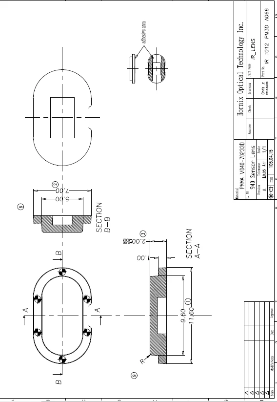

I'm use the coverglass indicated by the documentation:

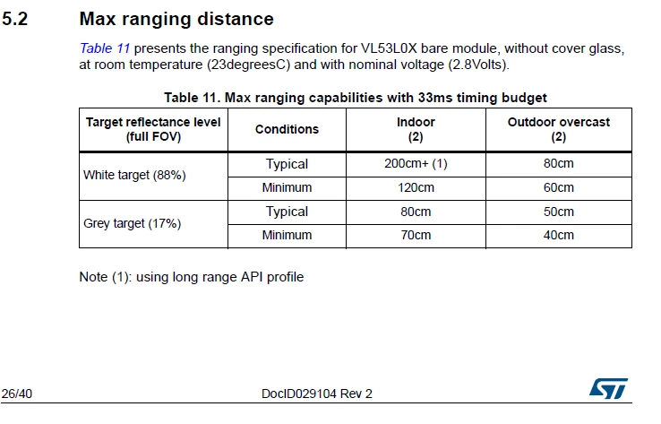

On the other hand, what are the limits to measure on a dark background?
Because the values ​​that appear in the documentation are on white or gray backgrounds.

Black is the hardest thing to range on. White returns more photons and thus can range at a much further distance.
So painting the target white is a great idea if you can.

But if you use that hornix coverglass, you will likely not need the crosstalk unless you want to be very accurate.
