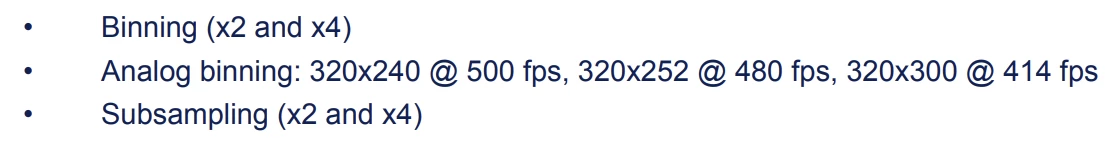

I'm evaluating the VD55G0 sensor - using the cam-55g0 camera module and the STEVAL-EVK-U0I evalkit. Looking at the datasheet and other documentation (VD55G0 - Compact and high-sensitivity 0.38 megapixel monochrome global shutter image sensor - STMicroelectronics), there are mentions of binning, analog binning and digital binning  in various places. Binning and digital binning seem to refer to the same thing and can be set to 2x or 4x in the eval-kit software. But the analog binning, indicated to provide higher frame rates, is not described in any more detail than just the info under "features". My question is if this really is an analog binning that can be performed on the sensor (in my understanding that is commonly not a feature for CMOS sensors) - or if this refer to some other operation (subsampling, cropping etc)? If it really is an analog binning, are there any way to evaluate this mode using the evalkit with the promodule cameras?
From the datasheet:
Best answer by mikequek
Hi Simon, we do not support Analog binning in VD55G0, all Analog Binning reference will be removed in the next version of Webpage, DataBrief & DataSheet.

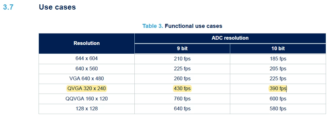

Thanks for the reply. Just a follow up question on the higher frame rates. Are the stated frame rates (e.g. 500 fps for 320x240 px) still possible to reach using sub sampling? Or should we expect some other limits?
November 6, 2024
Hi Simon, higher framerate for 320x240 can be achieved with subsampling as section 3.7 in DataSheet.
