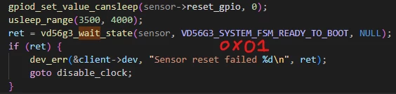

When starting the camera on port 1, the camera returns an error coming from the C driver:

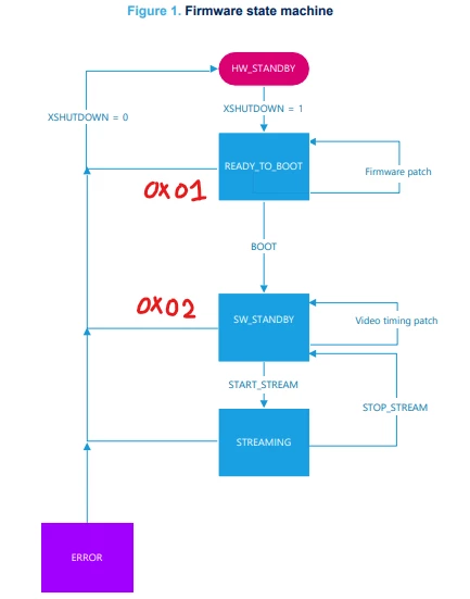

In the vd56g3_power_on function of the C driver, the code sends an I2C command to find out which state the camera is in. It expects the camera to be in the Ready_to_boot state (0x01) at startup. However, the camera on CSI1 goes straight to SW_Standby (0x02), so the function returns an error.
Since the camera is directly in SW_standby, I don't know whether or not it was configured by the driver. In any case, its state seems stuck in this mode; I couldn't switch it back to ready_to_boot or streaming.
This is where my understanding of the driver stops — I can't work out what the driver does after that. I saw that there are "CUT" and "fast boot" functions, and I don't know whether the camera goes through them or not, or whether the problem could also originate there.

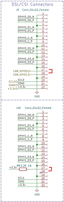

I also looked at the schematics of the IO Board 5 on which my Compute Module 5 is mounted, and I noticed that the CSI0 port has a GPIO on the camera's reset pin. That pin goes from its initial low state to high when I start streaming. On port 1, however, this GPIO is replaced by a simple resistor tied to 3.3 V. That means the camera can never be reset, and therefore never used by the driver.
So I desoldered resistor R8 and connected pin 17 of the MIPI port to a GPIO on the Raspberry Pi. I then modified the overlay to create a custom one and assign that GPIO to the reset.
As a result, I am now able to use both cameras at the same time.

I confirm that the issue comes from the CM5 IO Board. The missing XSHUTDOWN signal locks the driver in a “reset and retry” loop. The issue is also present on CSI1 with official Raspberry Pi camera modules.
The hardware modification of the board is a definitive solution for reliable behavior, allowing to reset the sensor whenever needed. Switching to a Raspberry Pi 5 is another option.
If you need to use the CM5 and cannot modify the hardware, you can use a quick software solution. Comment out pm_runtime_ops in the driver to keep it on. However, the driver cannot recover the sensor if an error occurs and the device enters the HALT state. You may need to power the platform off and on.
