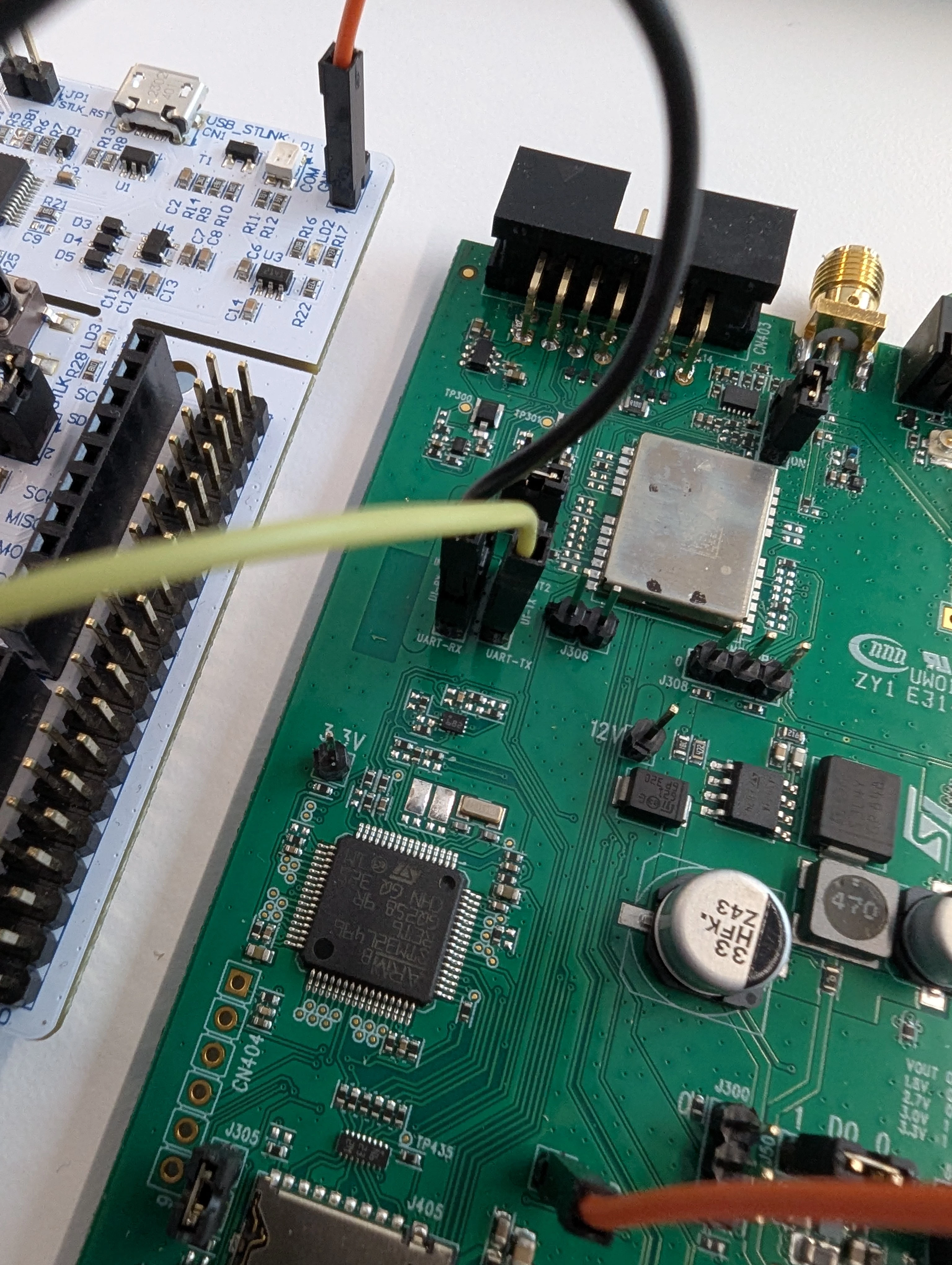

Jan 2, 2025 3:46 PM UTC
VIC3DA has 2 UARTs, UART1 and UART2. By default, NMEA is coming out of UART2.
Can you please tell me which UART (UART1 or UART2) you are tapping into?
Where you are connecting the UART lines?
Have you put a scope or logic analyzer on the UART TX pin to see if there is data coming out on the point where you are tapping into?

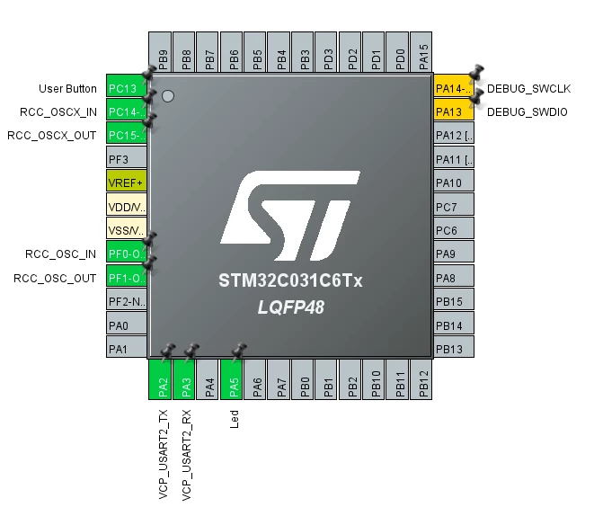

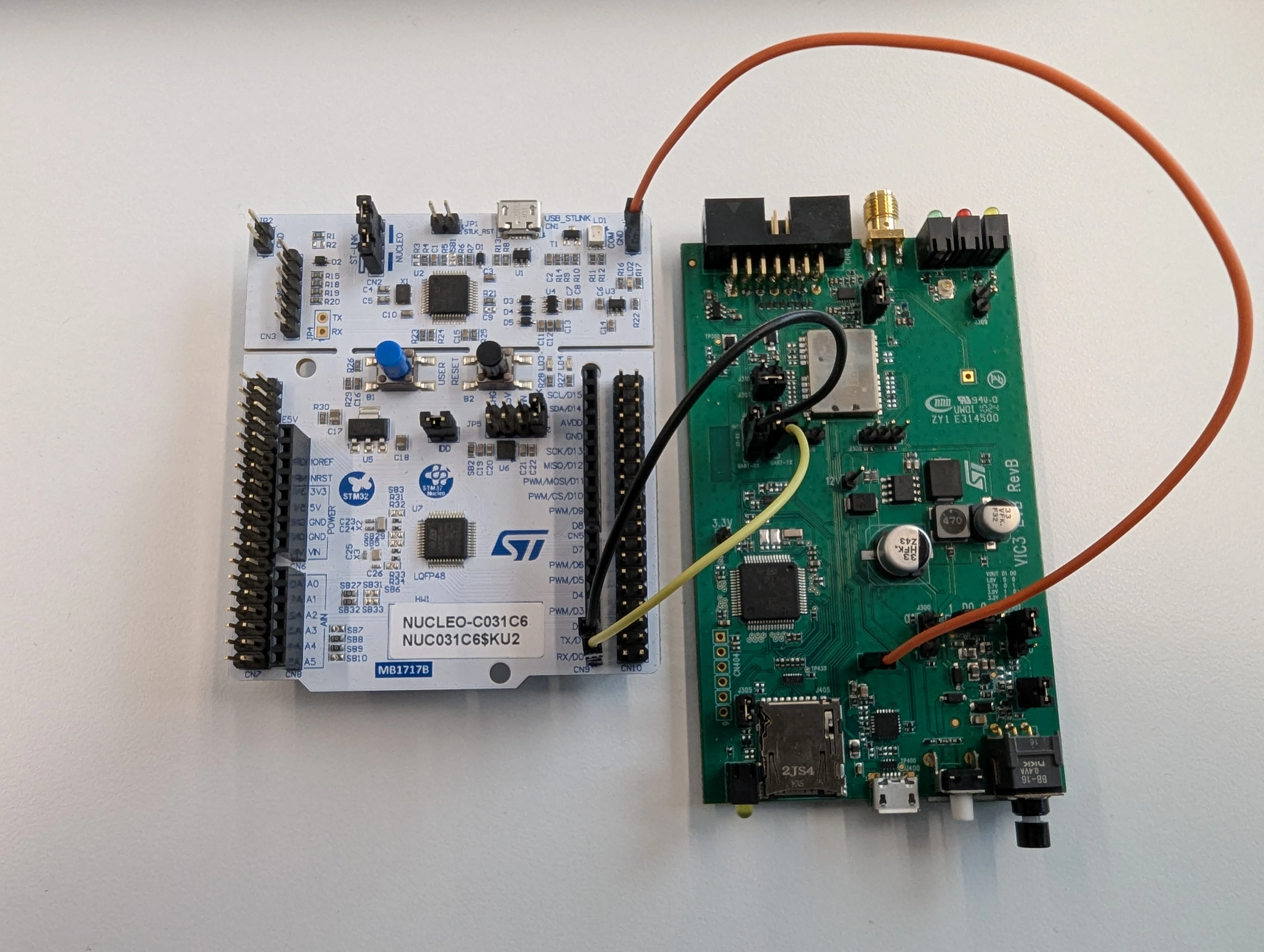

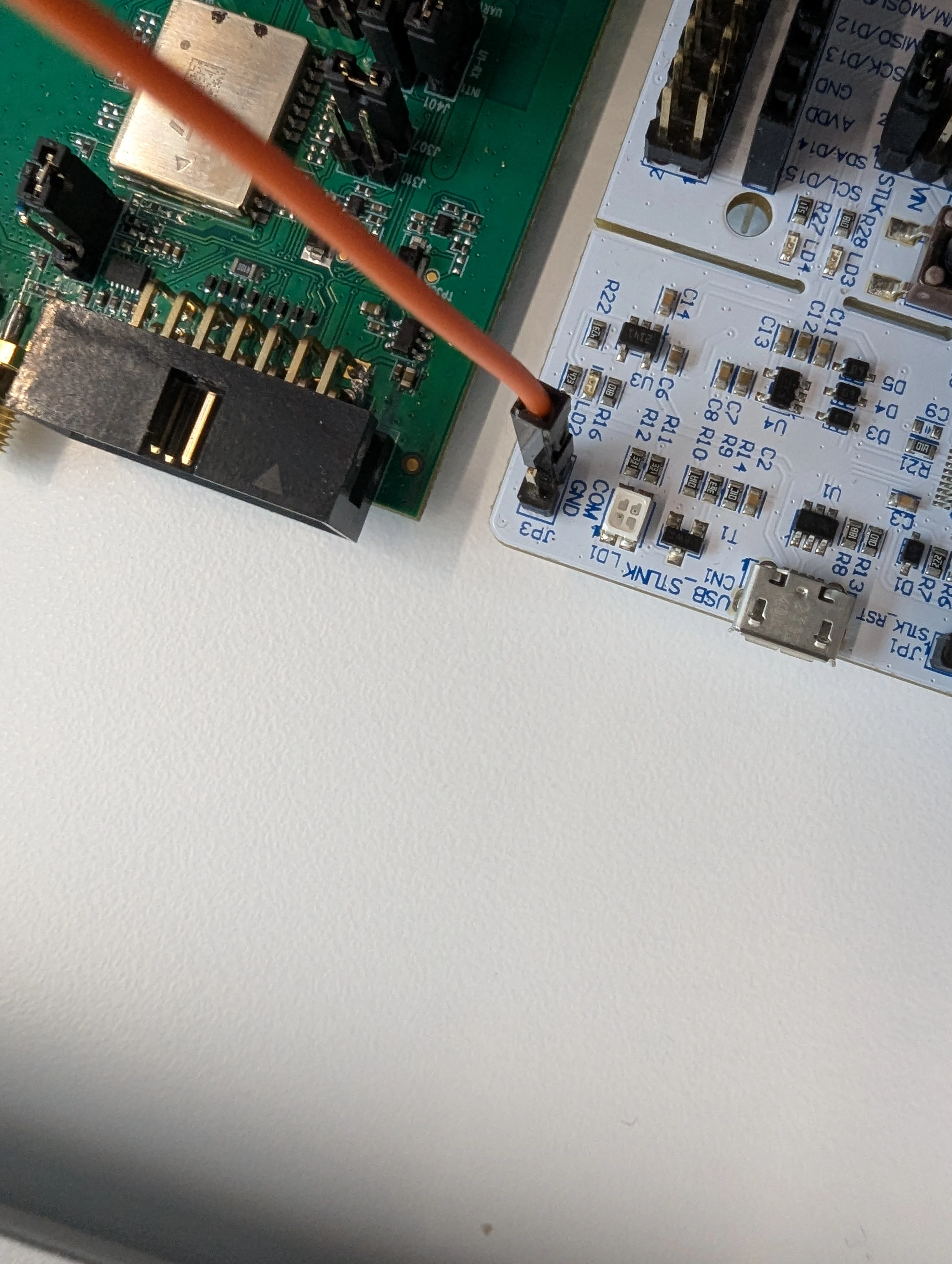

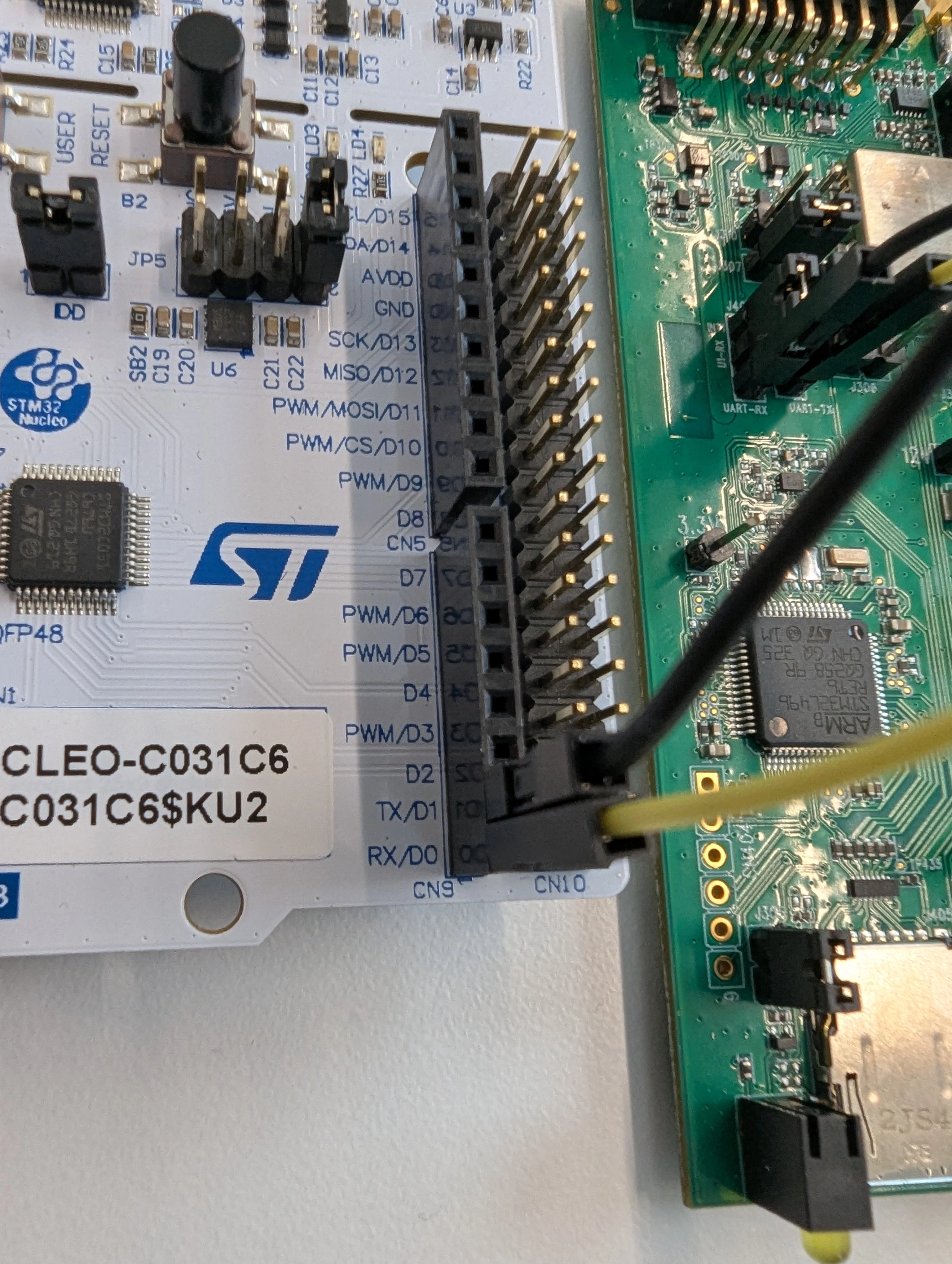

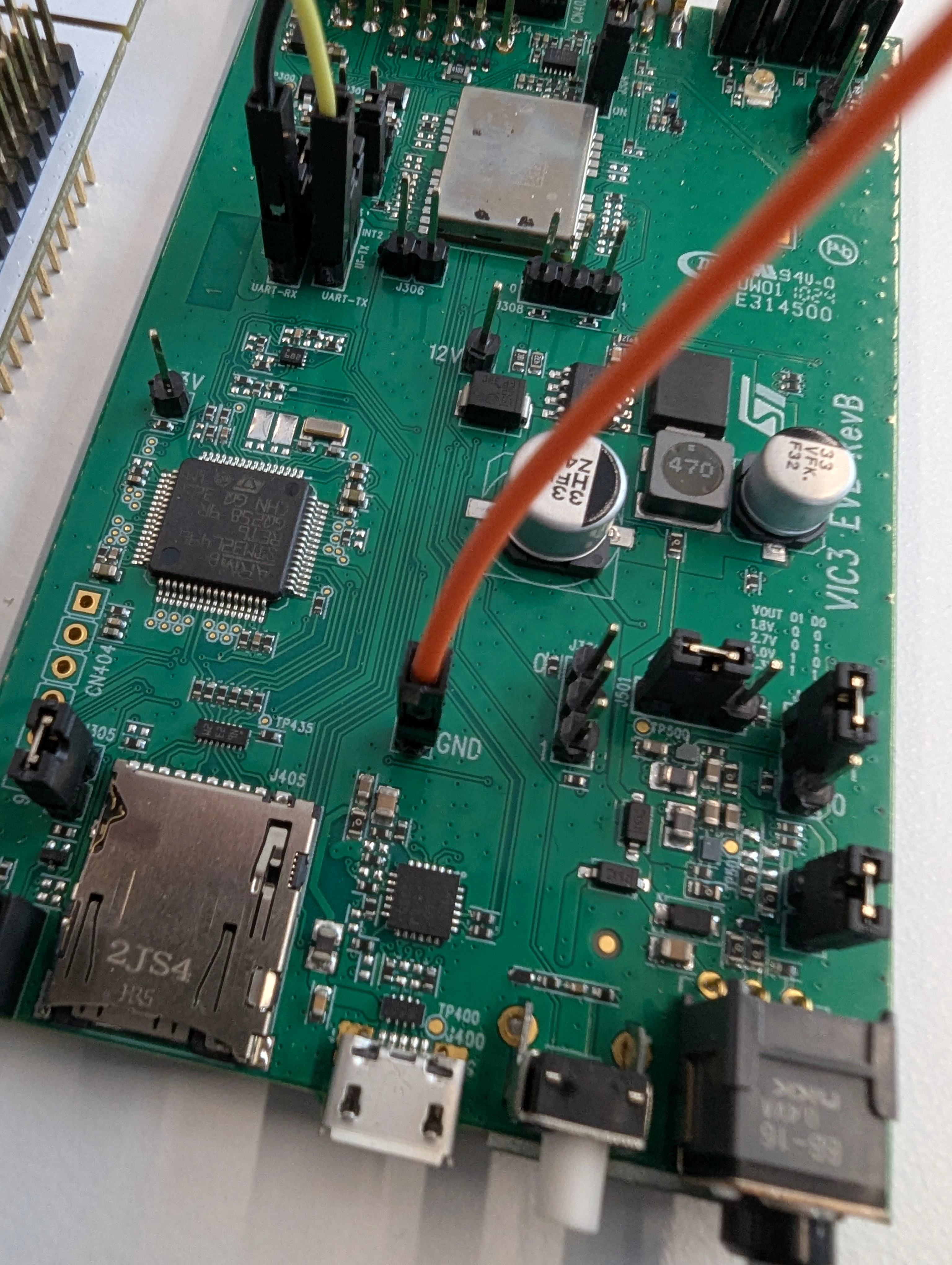

pin layout ioc filepin layout ioc filetx/d1 rx/d0 on the boardtx/d1 rx/d0 on the boardtx/rx on the gnss moduletx/rx on the gnss modulegndgndgndgndall wire connections between the boardsall wire connections between the boards

Jan 18, 2025 9:34 AM UTC
Isn't there a pin level conflict on the NUCLEO-64 with Arduino rail D0/D1 and ST-LINK VCP?
Why echoing NMEA back to receiver?

Jan 18, 2025 7:55 PM UTC
Looking at the Schematic  https://www.st.com/resource/en/schematic_pack/mb1717-c031c6-b02_schematic.pdf#page=3
PA2/PA3 (USART2) is for the ST-LINK VCP, can connect to rail via SB (Solder Bridges)
PB6/PB7 (USART1) is for the Arduino rail
Pins for MCU via Data Sheet tables
https://www.st.com/resource/en/datasheet/stm32c031c4.pdf#page=36
So interact with the VIC3DA via the STM32C031's USART1, and echo/diagnose through USART2 to the ST-LINK and the terminal connected to that COM/VCP
Jan 21, 2025 3:33 PM UTC
Hi
I have tried connecting directly using USB to PC and the values are coming in serial monitor. But not in MCU.
Andrew Neil
Jan 21, 2025 3:42 PM UTC
So now connect MCU to a PC serial terminal via USB-to-UART:
  • Verify that stuff sent by the MCU is received on the terminal
  • Verify that stuff sent from the terminal is received by the MCU
Jan 21, 2025 4:10 PM UTC
Hi
I have verified the stuff sent by the MCU (Just printed Helloworld).
I have verified both the stuff.
