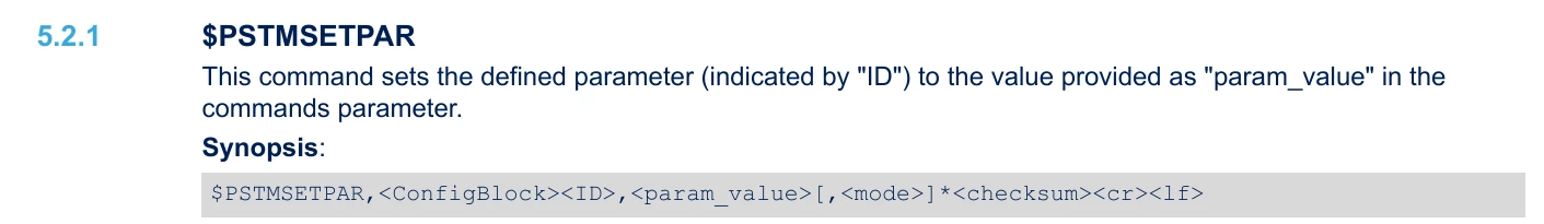

I have a TESEO LIV4F connected to an STMF411CEU6 via I2C. I am able to read the NMEA sentences ($GNRMC etc.) at 1Hz via I2C.
I would like to set the fix rate to the maximum 10Hz as outlined in the datasheet, but i am not able to do so. In fact I am unable to get a response for any of the commands I send via I2C. I only receive the NMEA data like $GNRMC
I've read through the documentation for the LIV4F, the software manual (UM3009) says that for the firmware configuration: "The "Factory Setting" can be changed and saved at run-time using specific NMEA commands" and also gives some I2C commands, so I am led to believe this is possible.
Has anyone been able to configure the fix rate via I2C commands in run-time?

> //I have also tried $PSTMGETPAR,1231 and $PSTMSETPAR,1190,0.1 with and without the "\n\r" and received no responses.
> static const char *cmd = "$PSTMGETPAR,1190\n\r";
What about the * and the checksum?

December 24, 2024
Hi Tom,
To update the GNSS fix rate, the CDB register that needs to be updated is CDB-303. The command you would need to send would be the the commands shown below
$PSTMSETPAR,1303,0.1 //sets update rate to 10Hz
$PSTMSAVEPAR //saves the values
$PSTMSRR //software reset device for value to take effect
//to read value back after reset
$PSTMGETPAR,1303
To send data to LIV4F module, you can use the API as shown below in app_gnss.c
uint8_t get_update_rate[] = "$PSTMGETPAR,1303";
GNSS_DATA_SendCommand(&get_update_rate[0]);
In our firmware, we do not have the code to read the response for $PSTMGETPAR. Therefore, you would need to manually add the code.
