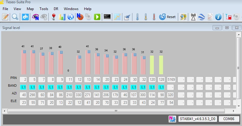

The teseo GNSS is outside, on the roof of the car.
I linked the Teseo GNSS to your Teseo-Suite Pro tool.
I requested the configuration with your Teseo Suite and the result is :
$$PSTMSETPAR,1227,0xbc0003d5*06
But as shown, your teseo GNSS can only see GPS satellites:
How is it possible that only GPS satellites are seen?
Is there any other configuration to check?
Once again, previously to this firmware update, GGA messages were GNGGA and not GPGGA only..
I attached the log file with the GSV messages.
Best regards.
Mich

Hi
In the Teseo-Suite configuration, did you 'NMEA 4.x' as protocol parser?
Regards
 Francesco

Dec 18, 2023 10:14 AM UTC
NO when I select NMEA 4.X the the signal level tool does not work!
Only the the view monitoring works correctly....
Do you have any other suggestion please?
Best regards
Mich

Hi
LIV4F as multi-bands device provides a NMEA-4.x ASCII stream.
Which Teseo-Suite version are you using?
In any case in the ASCII stream you can see if BeiDou/Galileo etc are acquired or not.
Regards
