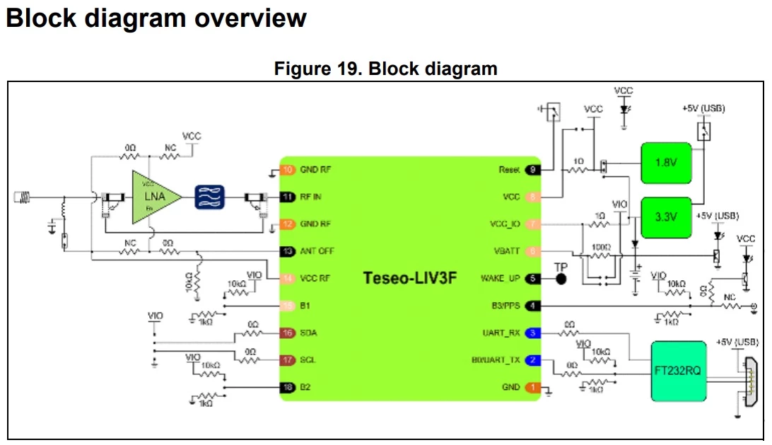

Hi team,
    I already have this module-Teseo-LIV3F( https://estore.st.com/en/evb-liv3f-cpn.html ) But i need communicat the L5 band NAVIC signal. In this module not supported the L5 NAVIC signal.
In this module-Teseo-LIV3F( https://estore.st.com/en/evb-liv3f-cpn.html )  replace the L5 NAVIC supported ic a Teseo-LIV4F(https://estore.st.com/en/teseo-liv4ftr-cpn.html)
This is supported or Not???
Thanks and Regards
Aravind.SR

AravindAuthor
Nov 15, 2023 5:30 AM UTC
Hi Francesco
              Pls give me the block diagram of (Teseo-LIV3F GNSS module Evaluation Board)
Thanks and Regards
Aravind.SR

Nov 14, 2023 1:28 PM UTC
Not sure what the question is. There's an EVB for the Teseo 4
You should contact sales directly via a local representative if appropriate. You could try filing as an Online Support Request via the support portal.
Interest outside India for NAVIC is relatively low, perhaps you have local technology or support that can provide a more timely solution?

Hi
Yes. Navic can be acquired on EVB-LIV4F.
Again take care you have to install the correct firmware (available on Teseo-LIV4FSW) to support Navic.
Regards
