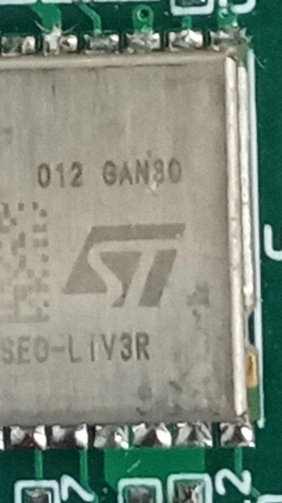

    Jul 1, 2022 4:16 PM UTC
    Hello
    We are having trouble to work with the TESEO-LIV3R
    It looks like we have chips that has old firmware
    We tried to update the FW using the Teseo-suite Pro
    but couldnt manage to do it
    As soon as we connect to the Teseo-suite we have connection to the Com port and as soon as we try to upload the Bin file it gives us the massage that it is in Sync and it doesnt proceed from there
    Is there any other instruction then that one that is in the ST web site or if you could help me I would appricate that
    BR
    Tzif
    We have GPS modules with the 0693W00000QKIAwQAP.jpg 012 GAN80
    Jul 4, 2022 7:33 AM UTC
    Hi
    Teseo-LIV3R is a ROM based GNSS module. You can NOT upgrade it.
    The module which support firmware upgrade are:
    • Teseo-LIV3F
    • Teseo-LIV3FL
    which are both Flash based.
    Regards
    Francesco
