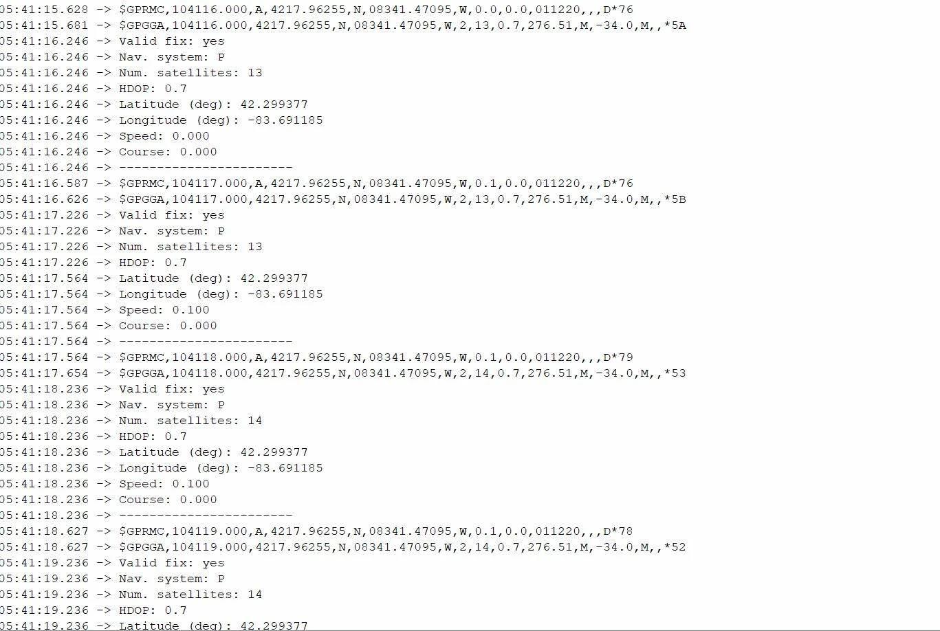

I am doing a GPS tracking project. I want to turn the GPS into standby mode or Enable Periodic Mode. I am doing the code in the Arduino IDE
For standby mode
I use the following code to set the GPS into standby mode.
MicroNMEA::sendSentence(gps,"$PSTMFORCESTANDBY,00010");
Can I use any code to wake the GPS up in software way?
I try the following code:
delay(5000);
MicroNMEA::sendSentence(gps, "$PSTMSRR");
However, the GPS received no signal anymore.
For Enable Periodic Mode
I used the code
MicroNMEA::sendSentence(gps, "$PSTMLOWPOWERONOFF,1,0,0,0,0,0,0,3,100,0,1,1,15,180");
But this makes no any change while reading the output from serial monitor.
Can anyone help give me a hint?
Thank you!

    I try to set the code in the setup and wait for almost one hour, but it seems that still not turn into periodic mode according to the GPGGA timestamp?
    MicroNMEA::sendSentence(gps,"$PSTMLOWPOWERONOFF,1,0,0,0,0,0,0,3,30,2,1,1,15,180");

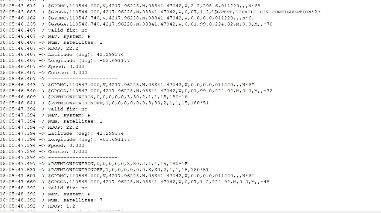

    Dec 1, 2020 11:00 AM UTC
    Hi
    When you send the command did you get '$PSTMLOWPOWERON,...' answer from the module?
    Regards
    Francesco
    PKuo.1
    PKuo.1Author
    Dec 1, 2020 11:09 AM UTC
    initially, I put this line of code in the setup loop, and I think I did not see the '$PSTMLOWPOWERON,.. from the serial monitor. But now, I put the code in the loop, so it will launch the code every loop and I can see the '$PSTMLOWPOWERON,.. right now. It is correct? Thank you
    PKuo.1
    PKuo.1Author
    Dec 1, 2020 11:43 AM UTC

    Hi, according to my code, I think I send the command "$PSTMLOWPOWERONOFF. However, I do not see the '$PSTMLOWPOWERON,...' answer from the serial monitor...
    Thank you
