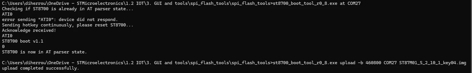

Dear MZina.1,
Indeed, as a general rule, ST does not disclose details about the bootloader.
To confirm that the bootloader is defective, please try a FW download using the “Boot Tool” (st8700_boot_tool_r0_8.exe) which can be found in the zip file “spi_flash_tools.zip” among the Application Notes list (saved on your PC when you have installed the GUI).
The sequence can be launched from a PC Command Prompt, as explained in the AN you mentioned (““ST87MXX_FW_Update_Application_Note.pdf”).
I put in attached a picture of my own result (I press and I maintain the “Reset” button before launching the .exe, then I release it when I see “please reset ST8700”).
Please share snapshots of your results.
PS: Note that for security reason, the chip prevents decommissioned versions : You can only install the same version or a higher one.
Best regards,

Press and maintain “Reset” and now it suddenly works! We have trying to reset modem after command was executed, on same time when executed etc. stupid mistake. Maybe you should put that exact procedure in documentation for us stupid people.
