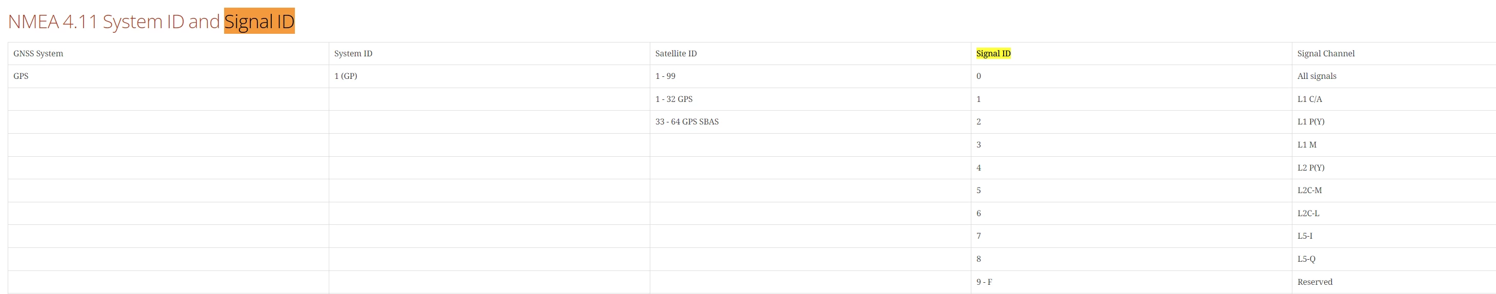

Here a definition for signal ID (from gpsd man) :

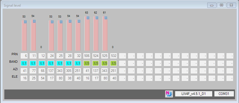

the teseo picture before the update  :
With new firmware, bagraph doesn't work.
Also, I have test have using $PSTMRF frame but doesn't like to work too.
