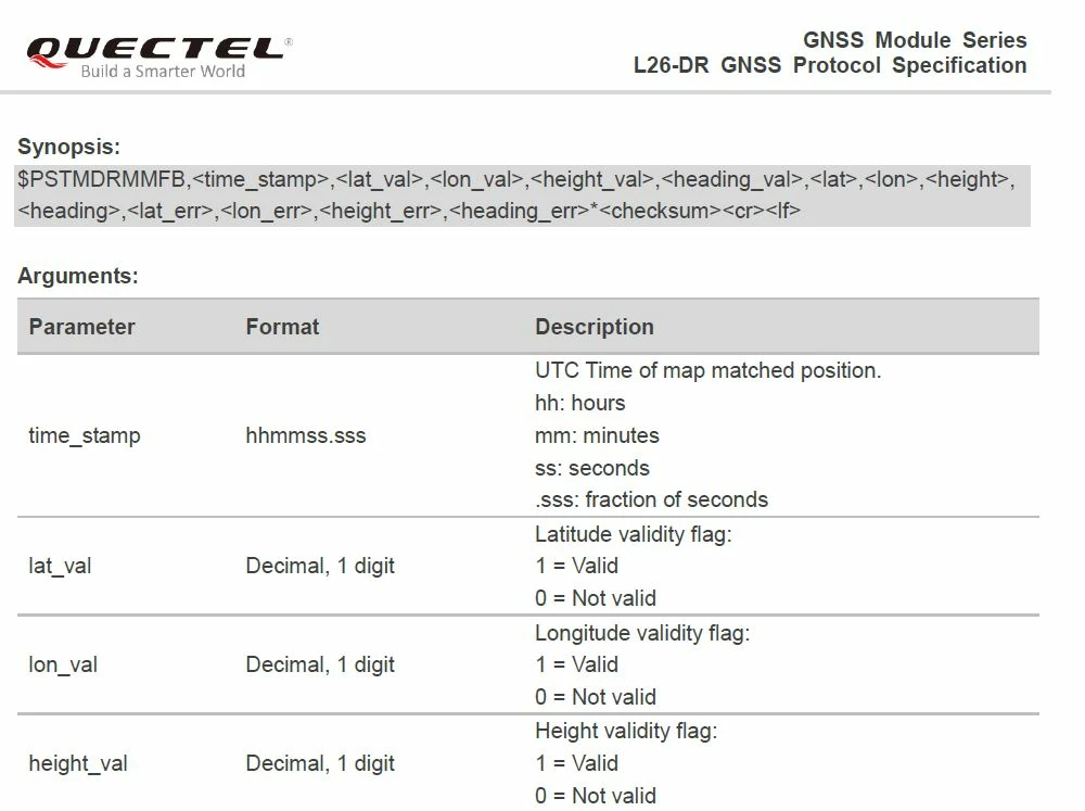

L26-DR GNSS - $PSTMDRMMFB command (Dead reckoning)
Hi, what is the function of this command?, the L26-DR GNSS Protocol Specification says “Input map match data�? but I don’t know when could be useful
Thanks
    5 replies
    Tesla DeLorean
    Guru
    Jan 11, 2021 11:44 PM UTC
    To establish the speed/location into the DR/IMU at some known starting point. Could be stationary if you want to clear sensor drift.
    For example outside an ambulance barn, exiting a parking garage, or a pit box with known location.
    Jan 12, 2021 7:34 AM UTC
    MMFB stands for Map Matching FeedBack.
    It can be used when the platform take data from a Map provider (i.e.: TomTom Map or other....) this map-information can be provided to the TeseoIII to improve the accuracy.

    And when should I send a validity flag as valid or not valid?
