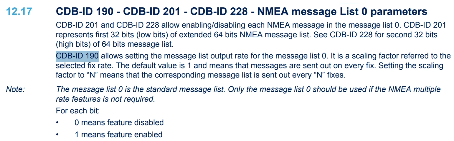

  • Previously, I also sent the command $PSTMSETPAR,1228,0x10000000,1, but since there was no save or reset command, I didn’t get the desired result. This time, I followed your three commands exactly and got the expected outcome—PSTMDRSENMSG was received at a frequency of 100 Hz. However, PSTMDRSENMSG is being exported too frequently, which is causing issues with my software buffer during processing. Could you help me set it to export at a frequency of 10 Hz instead? (I looked into UM2791, and Table CDB-ID 190 should help configure the export frequency of the messages, but there is no detailed description of how to use it.)

Thank you for your answer, but it seems you have misunderstood my point. Basically, the issue I’m facing is that the number of PSTMDRSENMSG outputs per second is too high, which forces me to increase the buffer size to receive the data (my buffer also needs to accommodate other messages such as GPGGA, GPRMC, etc.). Therefore, I would like to reduce the output rate to 10 Hz to decrease the number of PSTMDRSENMSG messages per second from the GNSS UART (this output rate will also be synchronized with GPGGA, GPRMC, etc., which will make it more convenient for me to process the data when reading it into my SoC).

Understood, I suggested increasing the baud rate to avoid any buffer overrun problems where the software is not reading the full message list sent if the UART is operating at a lower speed
We typically do not expose the buffer update rate because tweaking this value can interfere negatively with functioning of dead reckoning. Therefore, if you are using device for dead reckoning, I recommend you modify your software design to accept the buffer data,
If you want to change the IMU update rate, CDB-684 must be changed.
$PSTMSETPAR,1684,<imu_sampling_rate>
$PSTMSAVEPAR
$PSTMSRR
IMU_SAMPLING_RATE  is expressed in Hz.
Values from 15 to 150 Hz are accepted.
Letting the value to ‘0’ implies the usage of default fix rate, which is 100 Hz. A value lower than 15 also implies 100Hz sampling rate.
