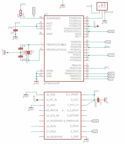

Is the Teseo-LIV3F compatible with Ublox Max7c or
Ublox Max7c and the GP-02 GPRS Series GPS + BDS Compass ATGM336H work in my circuit equally well...why not the Teseo-LIV3F ?

    My recollection is the teseo modules required a shed load of external components and the uBlox design is small and self contained.
    Will dig up the Nucleo shield schematics when I get to a computer.​

    Sort of a bummer...I was hoping it would work in my current circuit as is.Maybe it does not pay to get things fast...now have to wait longer for the proper GPS.
    This is my schematic using Ublox and generic which work perfectly fine.May be too small to see,but basically GPS wired to Atmega 328p-au using one cap at v3.3v .

    Ciao
    > is this TESEO-LIV3F compatible to replace the other GPS modules I have mentioned
    Yes . It is.
    Do you see the PPS pins toggling?
    Uart.Tx boardrate is @ 9600
