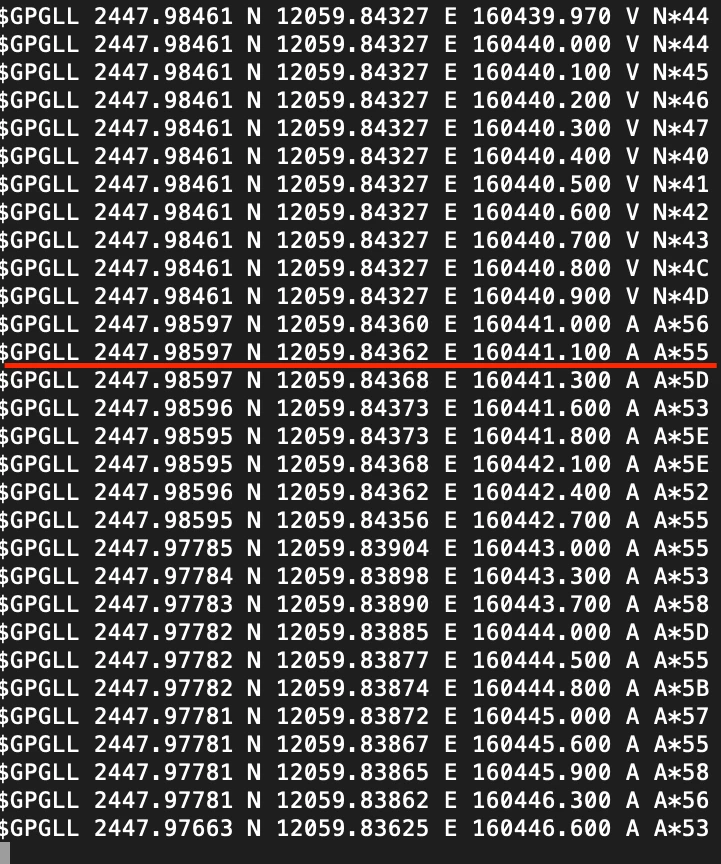

Hi, I can't get the correct fix rate for x-nucleo-gnss1a1
Using following command:
$PSTMSETPAR,1303,0.1,0
$PSTMSAVEPAR
$PSTMSRR
what I expected is update rate 10Hz, i.e., the timestamp is increasing 0.1 each time.
However, the result is
above the red line, one can see that it is updating at the rate of 10Hz
below the red line, it is updating at the rate approximately 3Hz
If I reset the program, it will maintain 10Hz for about 1 sec, then back to 3Hz.
If I power off the stm32 and power on, it will maintain 10Hz for a while, then back to 3Hz.
Any idea or advice will be appreciated, thank you so much.

    Hi
    I'm sorry you are right.
    The system is "trying" to running @ 10 Hz but the cpu_clk is too low.
    The right scripts is:
    1. $PSTMSETPAR,1130,00,0 cpu_clk @ 192MHz
    2. $PSTMSETPAR,1303,RATE,0 rate is float (i.e: 0.1, 0.5, etc)
    3. $PSTMSAVEPAR
    4. $PSTMSRR
    The first setting increases the (internal) cpu_speed to guarantee the cpu can support 10Hz
    Moreover also a reduced message-list can help but the highest CPU_clk is mandatory
    Hope this helps.

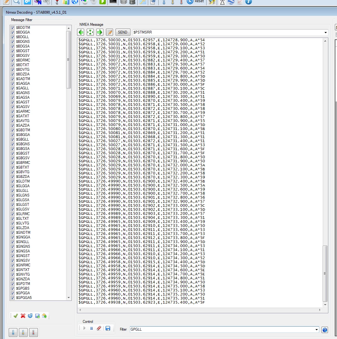

    Mar 4, 2019 12:54 PM UTC
    Hi
    10Hz has to be working with and without valid ('A') field.
    I have it working without problem as you can see in the image
    I used the scripts provided in the past I also increased the UART-baudrate (115200)
    No more than that. May be due to a baud rate too low the systems is skipping message
    Let me know
    Regards
