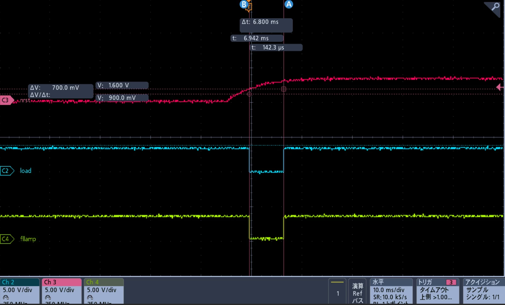

I am doing a project on STM32F479ZGT6. I set all my pins to HIGH default, open drain, external pull up on STMCubeMX. During power on, the IO pins first follows 3.3V by the external pull up, but then two of the IO pins becomes LOW during reset release, and then after reset is completely released, it turns back to HIGH(default logic set in STMCubeMX). Does STM32 has the ability to change logic opposite from the default logic only for a moment?(which in my case is during reset release) Would be glad to know any possible cause and solution for this case.
Red: Reset
Blue &Green: IO pin

The vast majority of pins are in a high-z state when the chip is in reset. There is no ability to change this behavior.
If you need a pin to be in a defined state, the only way is to use an external pullup or pulldown resistor.
“External” pull up is not a setting in STM32CubeMX. The pullup/pulldown settings refer to internal pullup/pulldown resistors.

I beg your pardon. For the STMCubeMX setting, I set it to no internal pull up/pull down and then connect it to external pull up. The connected external pull up should be not making the IO pin to be left floating.
August 6, 2026
Ahh, so the problem is the pin is getting pulled low at/during startup. Which pins are these? Are you setting the state to high before you make them an output? Does it happen if you leave the pin as input?

You can try make reset signal more sharp, reduce capacitor at NRST, even use reset IC like TI TPS3703, TPS3899…
If this doesn’t work, you can play with PDR_ON pin, change different power on reset.
More than this, you need carefully control power on/off sequency,
If power sequency no good, your product lifetime may reduce.

You can state WHICH TWO PINS of STM32F479ZGT6, and then let’s check the DS&RM.
Some specific alternate functions related, maybe.

In reset signal not stable period, (in your case 0.9V - 1.6V) chip status is unknown, This is normal for most chip.
August 6, 2026
The chip status is either in reset, or it has started. In either case, the pin should be high provided the initialization is correct. I don’t see how this explains anything.
It is not normal for pins to toggle during startup.

In particular, as the others have said, you need to state which pins you’re looking at.
Also, show the schematic.
Some good, clear photos of your setup may also help.
