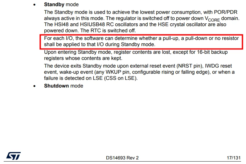

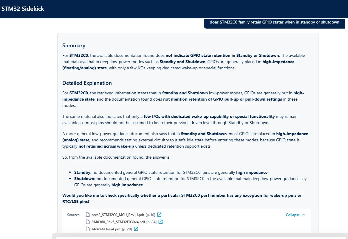

SideKick wrong on C0 GPIO in STANDBY
  • August 3, 2026
  • 3 replies
  • 92 views
But C0 does have the option to configure pull-up/down in STANDBY:

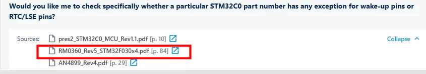

Note also that it references the wrong RM:

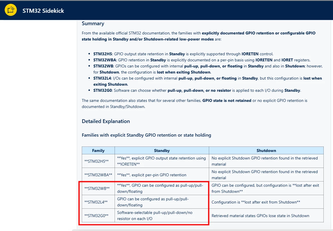

When asking the question more generally, Sidekick does note the pull-up/down option for other families - but does not include C0:

Hi ​@Andrew Neil ,
Thank you for the valuable comments ,We will check how we can improve in our next roadmap . Is that possible to check again today, we updated some reasoning feature .
Thank you
STOne-32

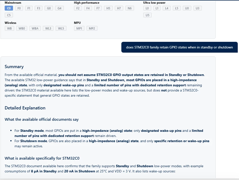

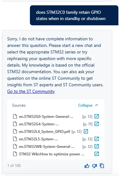

Andrew Neil
August 4, 2026
Today it just says, “Don’t know”:
That was just asking the question - without checking the ‘C0’ box before the query.
Checking that box gives pretty much the same as yesterday:

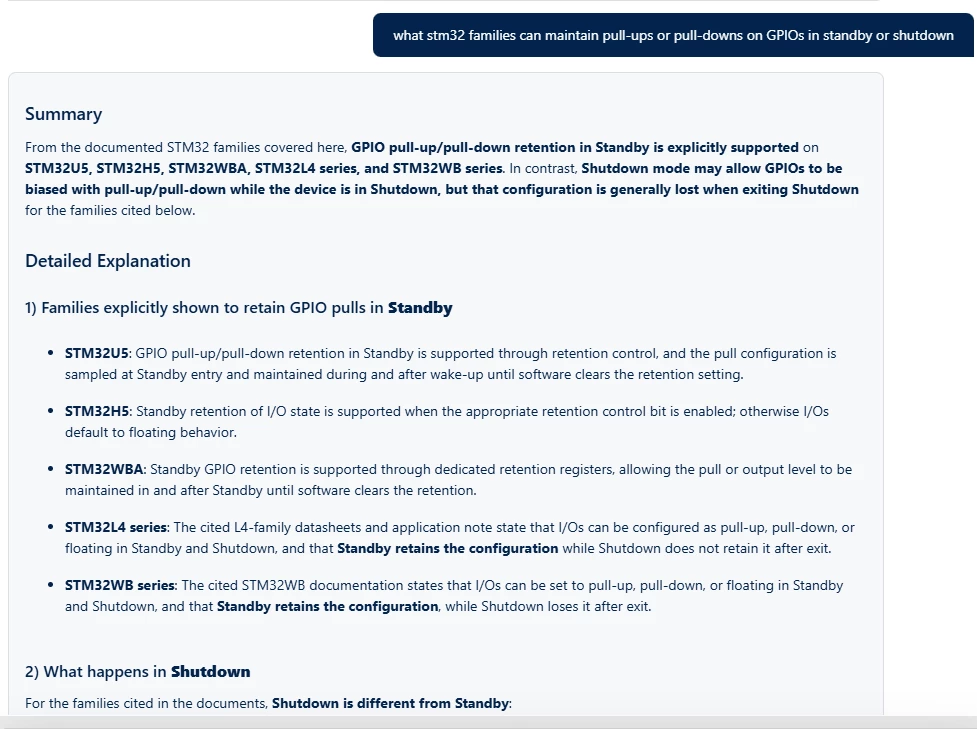

Andrew Neil
August 4, 2026
The answer to, “what stm32 families can maintain pull-ups or pull-downs on GPIOs in standby or shutdown?”  also omits G0:
