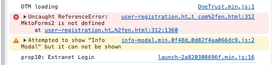

I have a number of people (including myself) that cannot log in to the ST website or register an account here in Australia. I personally have tried three different operating systems, two different internet connections, three different browsers, and even one fresh install of linux in a virtual machine and all three show the same problem. I have also had multiple colleagues try on their computers on different internet connections and they too are not able to log in properly. The login is also broken in CubeIDE.
The problem with the registration form is that you cannot submit it. The problem with the login page is that you submit it and it just redirects back to the same login page without logging in.
If I try to submit on the login page with an incorrect password, I get the error "null", so I know that it is at least processing the password in some way.
Whereas if I enter my correct password, I get no error and I just get sent back to the login page.
On the registration page, if you open the javascript console in the browser, you get this error message (it's also present on the login page):

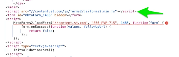

This "Uncaught ReferenceError: MktoForms2 is not defined" means that whatever forms library your website is using is not loading correctly. Looking at the HTML of the page, you can see that this is loaded via a javascript file called "forms2.min.js":

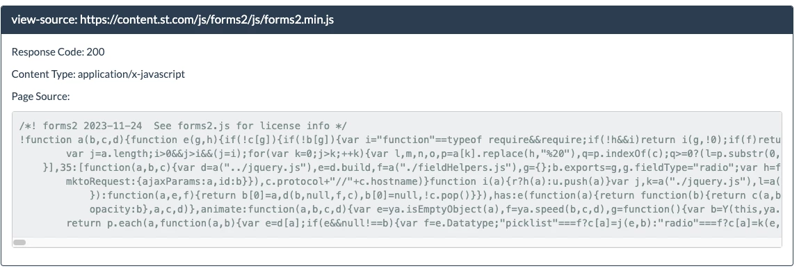

However, if I go to https://content.st.com/js/forms2/js/forms2.min.js I do not get a javascript file, in fact I get the contents of a different file which is more commonly known as a robots.txt file:
Given that this is not javascript. The website breaks. This content.st.com website is presumably part of a Content Distribution Network (CDN) that is used to distribute common files for websites, and it is very likely that you get allocated to a different server depending on where you are on the planet.
I then tried an online HTTP access website: https://wget.alanreed.org/ which I believe is based in the USA to access this same URL:
From this location, the javascript file appears to be served correctly. So it seems that currently your CDN is serving incorrect files to some locations of the planet (or whatever heuristic your CDN uses to select a server). What you need to do is to contact your web team and ask them to please make sure all CDN servers are up to date and not serving stale files.

Thank you! Overnight it seems someone updated the CDN, the javascript file has its copyright date changed from 2023-11-24 to 2024-01-29 and the registration page now works (the javascript errors are gone)! I really appreciate your help on this.
/*! forms2 2024-01-29 See forms2.js for license info */
