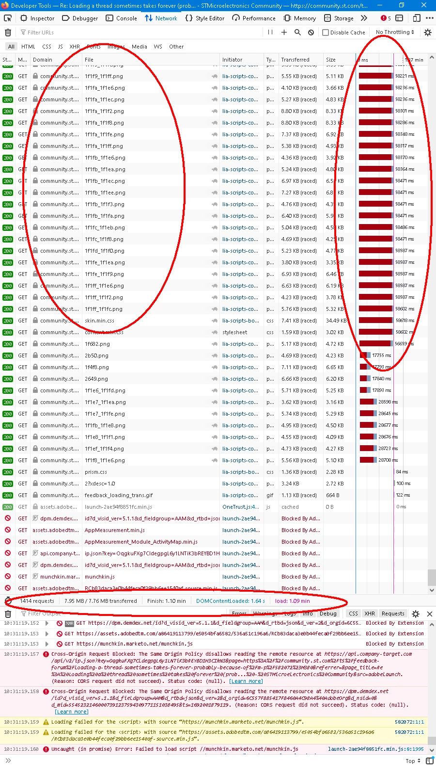

Loading a thread sometimes takes forever (probably because of 1500 emojis)
It appears to be consequence of loading 1500 icons for emojis.
Just switch emojis off.
If you think we need them (and we really don't), use Unicode emojis instead of 1500 jpgs.

Yes. This is log from loading this very thread:

For me the unacceptable lag occurs when I click in the reply field  (not when the thread page loads initially).
Especially, on older smaller slower machines. Browser: MS Edge (updated).
On ipad & Safari - the delay is annoying but tolerable.
Example of "good" machine: i7, 16 GB RAM., SSD.
Example of poor machine: Intel Atom or AMD Brazos, 4GB RAM, hard disk.

Per @Pavel A. the whole Hit Reply to viable editor on Chrome, using several relatively high bandwidth cable and fiber nodes, has way too much latency.
Bit like Musk's complaint about rendering a 1000 things in twitter.

This issue apparently got "fixed" so that the 1500 emojis are not loaded when the thread is loaded, but when reply is started.
So the consequence is, that threads now load faster, but trying to reply takes forever.
Seriously?
Just switch the emojis off. This is a technical forum, not a chitchat. Grow up.
