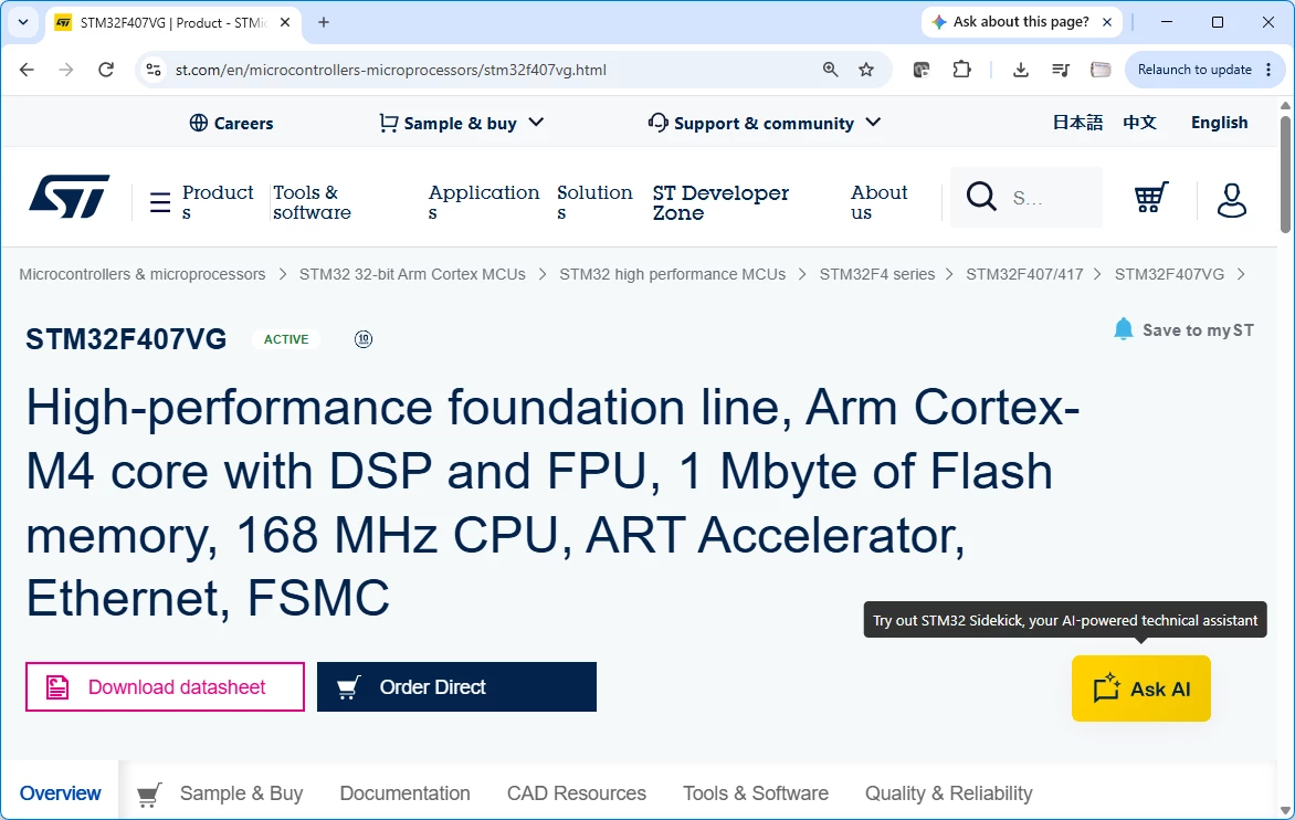

This applies to both the ‘Download datasheet’ button on the main page:

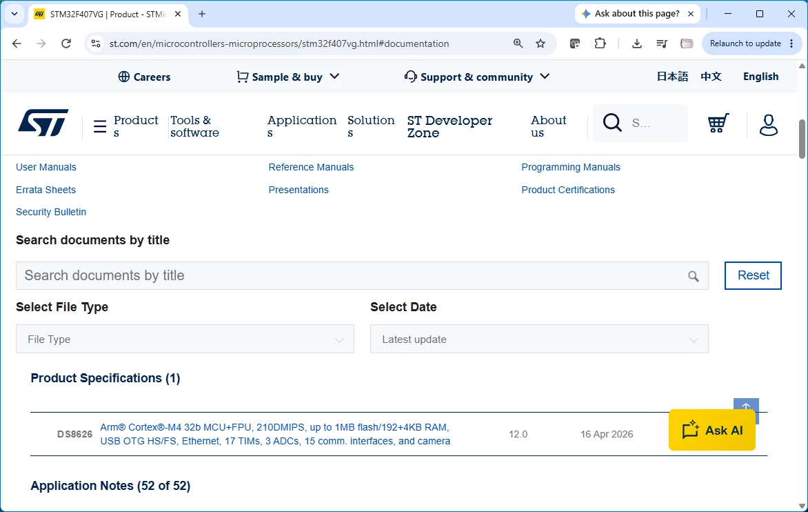

and the link on the ‘Documentation’ tab:

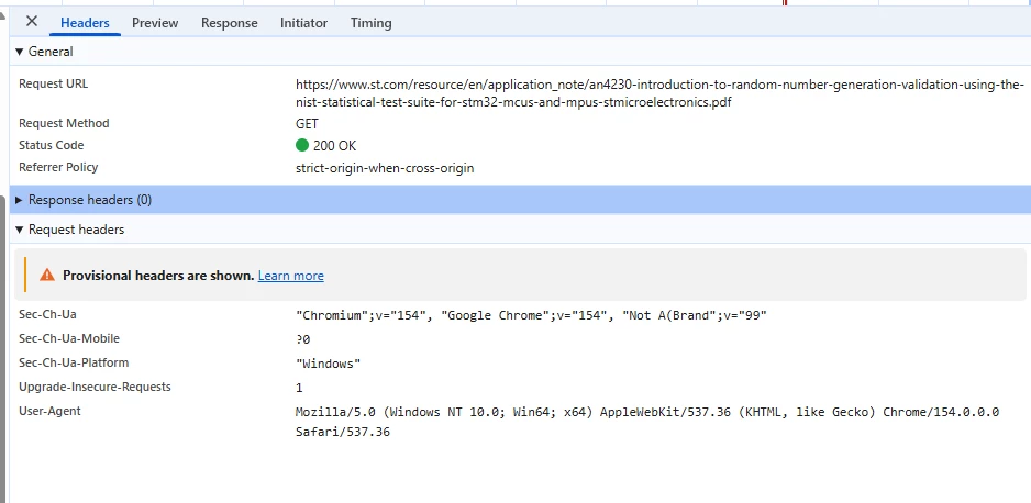

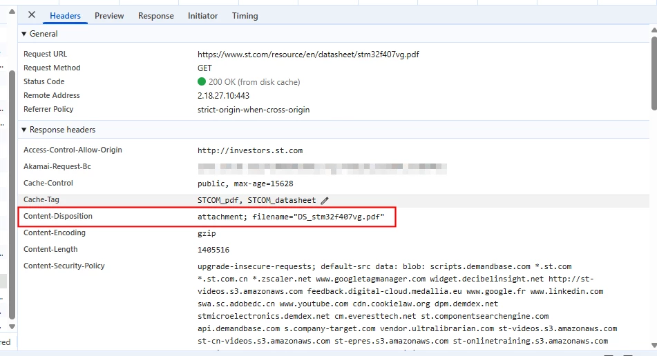

This is what I see for that datasheet in Chrome’s “Developer Tools”:
For the App Note:

Thus it seems that the ST website is using the wrong Content-Disposition header in its response:
  • attachment forces the browser to download the file;
  • inline would allow the browser to display it.
https://stackoverflow.com/a/1395173
