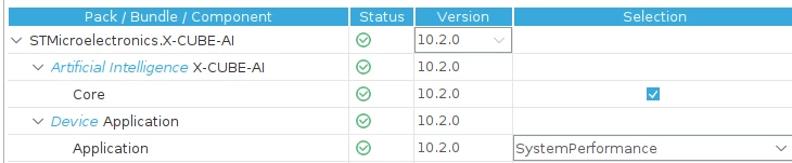

I am creating a new project on an STM32F4 nucleo board. I configured the X-CUBE-AI library as shown below and specified a TFLite model:
When generating code on a fresh project, the "Middlewares" folder is not generated. The project fails to build because the "ai_platform.h" file is missing (it should be in the Middlewares folder). The problem occurs with a fresh STMCubeIDE project and with a fresh STMCubeMX project.
I noticed that the "Middlewares" folder is generated correctly once I add additional libraries, such as FreeRTOS. In this case, both the FreeRTOS and the X-CUBE-AI code is generated correctly in the "Middlewares" folder. However, I don't want an RTOS for my application.
How can I only generate the code for X-CUBE-AI?

I made some additional observations:
  • The "Middlewares" folder was generated but only on the first code gen of a project - if code is generated again, then the "Middlewares" folder is deleted, even though the project code depends on it. (I only checked for STCubeMX standalone + CMake build system).
  • My current workaround is this: I generate the code once and immediately save it to git. When the model is changed and code is generated again, then I keep the updated model code and restore the now deleted "Middlewares" folder. Not the best solution though ...

Hello @kahuna,
Thank you for this information.
We will look at it on our side.
I can point you to these documents that may help you:
https://stedgeai-dc.st.com/assets/embedded-docs/stm32_command_line_interface.html#update_c_files
and
https://stedgeai-dc.st.com/assets/embedded-docs/stm32_how_to_run_a_model_locally.html
To give you context, X Cube AI is just a GUI in CubeMX to use the ST Edge AI Core, but you can directly use the ST Edge AI Core CLI if you want, to bypass the bug.
As you already installed X Cube AI, you have the ST Edge AI Core installed on your PC at this location:
C:\Users\USER\STM32Cube\Repository\Packs\STMicroelectronics\X-CUBE-AI\10.2.0\2.2\Utilities\windows
Have a good day,
