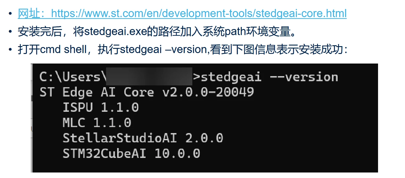

win11  install st edge ai core(version4.0.1) ,everything is ok,but doesn't have a shortcut(try 3 times),  and it doesn’t work, what's wrong? st edge ai core has bugs? Help me!

stm8l101Author
Jun 16, 2026 10:00 UTC
this is the answer!

Hello ​@stm8l101
ST Edge AI Core does not create any shortcut once installed.
Installation are available under:
C:/ST/STEdgeAI/X.Y
Where X.Y are “Major” and “Minor”.
In your case, you should find C:/ST/STEdgeAI/4.0/Utilities/windows/stedgeai.
You can still expand your PATH including C:/ST/STEdgeAI/4.0/Utilities/windows folder if you want
Best regards,
