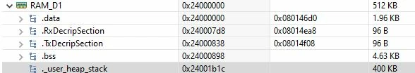

I've tried statically allocating the buffers as global variables, but the same issue occurs.
I've also tried increasing the stack size, and no matter how large I make the stack/heap (see images below), the exact same hard fault issue occurs.
Are there other suggestions as to what may be causing the issue?
