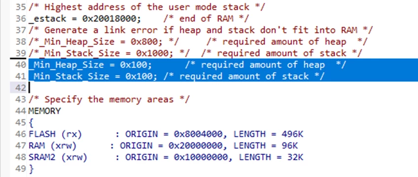

What is meaning of the " region `RAM' overflowed by 4240 bytes" error while compiling ASC source code with STM32Cube.IDE?

c:\st\stm32cubeide_1.10.1\stm32cubeide\plugins\com.st.stm32cube.ide.mcu.externaltools.gnu-tools-for-stm32.10.3-2021.10.win32_1.0.0.202111181127\tools\arm-none-eabi\bin\ld.exe: B-L475E-IOT01A.elf section `._user_heap_stack' will not fit in region `RAM'
c:\st\stm32cubeide_1.10.1\stm32cubeide\plugins\com.st.stm32cube.ide.mcu.externaltools.gnu-tools-for-stm32.10.3-2021.10.win32_1.0.0.202111181127\tools\arm-none-eabi\bin\ld.exe: region `RAM' overflowed by 4240 bytes

It means, that you have too many variables to fit into RAM.
Have a look at the mapfile (B-L475E-IOT01A.map) to see how RAM is occupied.

Please try to change the mininum size of heap and stack as following:
  • File name: LinkerScript.ld
