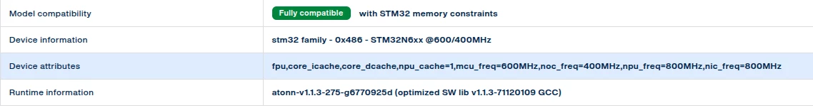

I’m using STM32Cube AI Studio to optimize and validate an ONNX model on a NUCLEO-N657X0-Q board. In general, everything works fine. However, I would like the board to be configured in overdrive mode (npu_freq = 1000MHz, mcu_freq = 800MHz) by Cube AI Studio for the validation runs on the target because I’m hoping to achieve a better inference time.
When executing new “runs” in Cube AI Studio, the device attributes are always as seen in the screenshot below.
Results overview of a run in Cube AI Studio

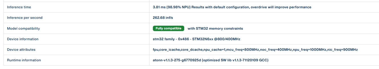

If I use the the ST developer cloud to optimize and benchmark my model with the STM32N6570-DK board (because the NUCLEO-N657X0-Q is not available in the DC), the device attributes are as follows:
Device attributes for the benchmark in the developer cloud
Since those two boards have the same STM32N657X0H3Q MCU, I expect a similar inference time on my NUCLEO-N657X0-Q board with Cube AI Studio if I could just activate the overdrive mode.

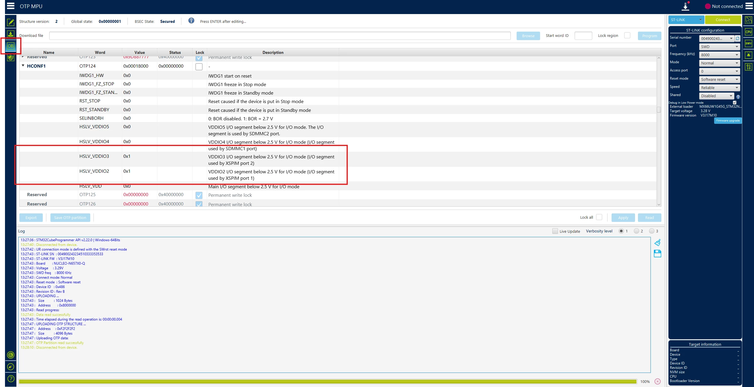

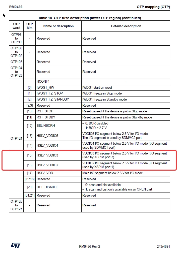

First of all, to have best performance, you need to break OTP fuse to allow higher voltage for XSPI
This can be done through STM32CubeProgrammer. To do so, please execute the following:
  • Open STM32CubePrg
  • Connect to your NUCLEO-N657X0-Q
  • Go to “Option Bytes” (OB) menu
  • Scroll to HCONF1 / OTP124
In the lines HSLV_VDDIO3 and HSLV_VDDIO2, ensure you have value “0x1”. If not, apply the following for both of them
  • 1 (not 0x1, it sounds counterintuitive but 0x1 is not allowed by the GUI)
Press “Apply”

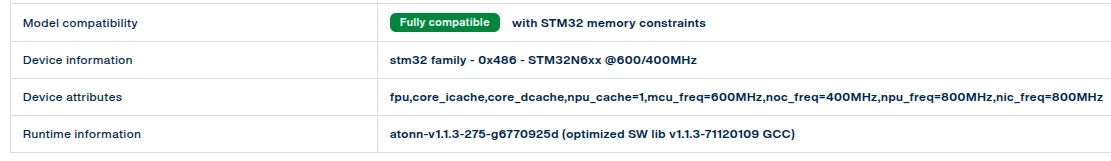

thank you very much for your reply. I did exactly what you described above, but unfortunately it seems like Cube AI Studio is still using the old settings. I double checked if your updated boardExternalMem.xml file is really stored under the given path and it is.
I’ve attached the the .ioc file from the respective “run-n” folder generated by CubeAI Studio where the clock config still shows the frequencies from the screenshot above. Also, in the meantime I updated to version 1.3.0. But I don’t think this is the issue why it’s still using the “standard” clock settings.
However, thanks to your explanation on how to break the OTP fuse I am now able to edit the .ioc file generated by CubeAI Studio manually to overdrive mode. After regenerating the code with CubeMX, rebuilding the project and flashing it again, I was able to use the “stedgeai validate” command validate my my model in overdrive mode. So with this workaround I should now be able to use my model for my application with the board running in overdrive mode.
